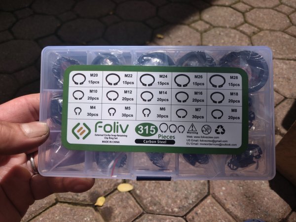

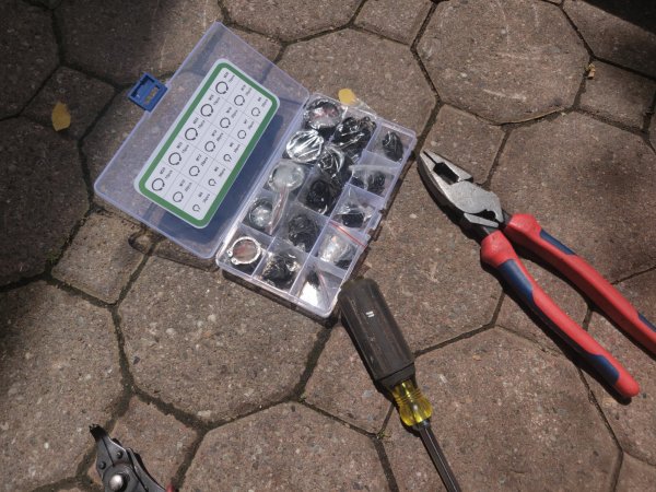

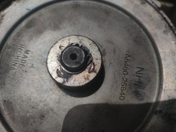

    Well I got my snap ring kit today and plopped a new one on top of the tranny pulley and fan. M12. I tried the M14 and it seemed a little loosey goosey.
    The seal kit should arrive tomorrow. Getting pretty excited!

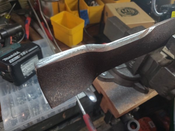

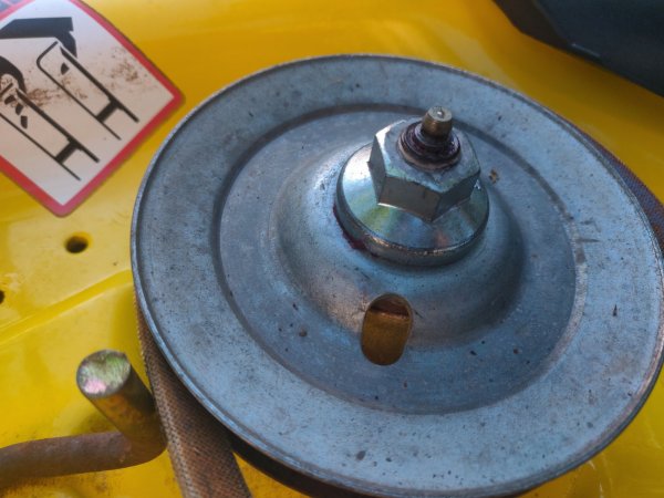

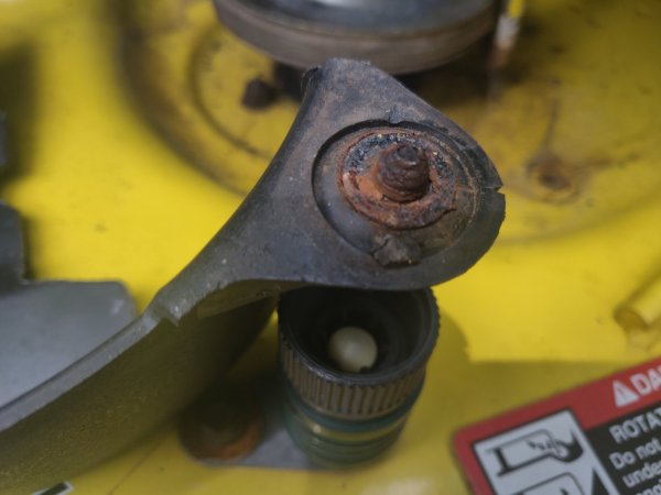

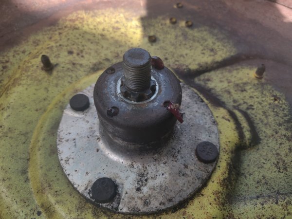

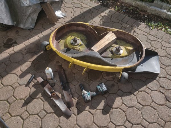

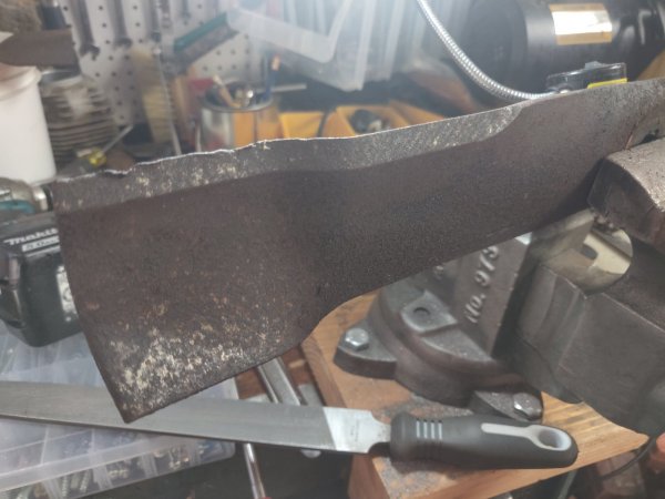

    I've never sharpened lawn mower blades before but these had taken a bit of a hit. I probably sharpened them too sharp but that's alright. I did balance them on a socket and because I did it by hand with a bastard file it was pretty balanced.

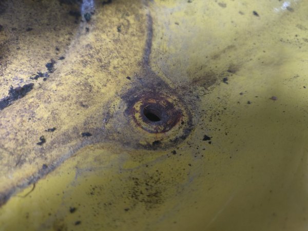

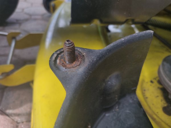

    I also greased the two zerk fittings for the main pulleys on the mower deck. Luckily I was able to spin the nuts off with my Makita 18v cordless impact. Had soaked it in PB Blaster for a few days while sick.
    I only saw a tiny bit of grease come out but I sure was pumping away.

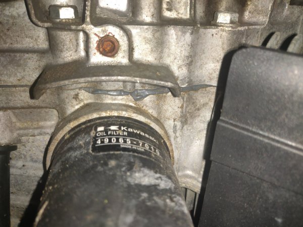

    Also going to change the oil filter just because. And since there was almost no oil in the engine when I got it, I'll probably do that sooner rather than later and then mow the 12sq ft of grass I have lmfao. I may be tempted to offer to mow my neighbor's lawn for free just as a test hahahaha.

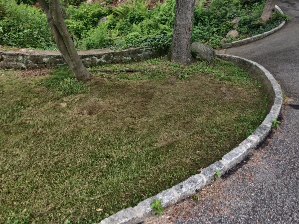

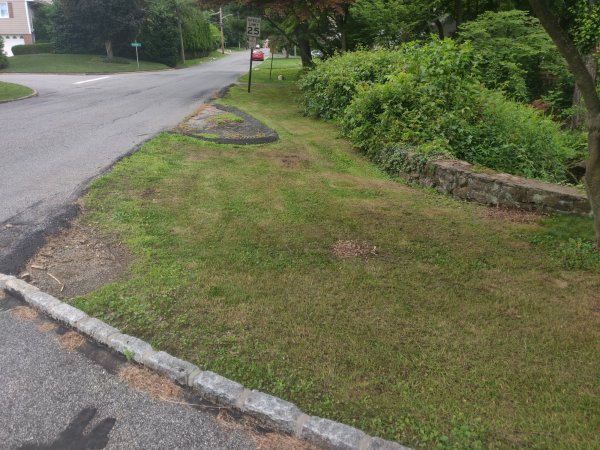

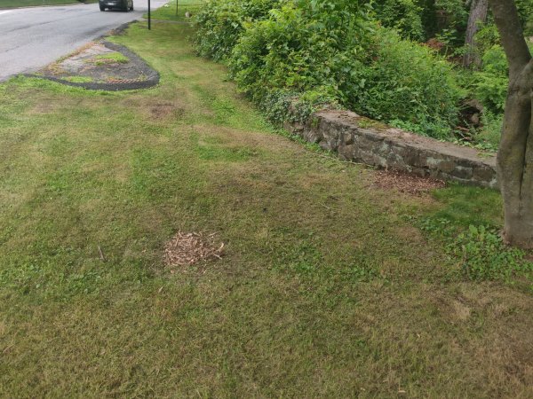

    Reinstalled the blades, leveled the deck as best I could (my flat parking spot is not perfectly flat but close enough I guess), engaged PTO and went about 30 feet. Forgot to lower the deck, engaged PTO, smelled burning rubber. Returned to parking deck. :hair:

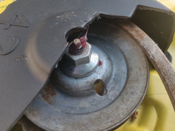

    When I reattached the drive belt I must have slipped off the pulley that has the cover on it because that cover blocks your view. Thankfully I did not trash the belt but I surely shortened its life lmfao. :headbang:
    I had set the deck height to 1.5" and adjusted the roller wheels appropriately but in hindsight that was a little aggressive. Looks like I shaved the lawn lmfao. I did scalp it in a few spots, the most noticeable was an old stump that was almost gone but not quite. No big deal.
    I need a string trimmer now because obviously the machine can only get so much. I filmed it as well and will edit the footage but for now pics will do.
    Pretty darn excited!
    My neighbor across the road said I could mow his lawn to test out the tractor but I'll have to get the string trimmer before I do that.

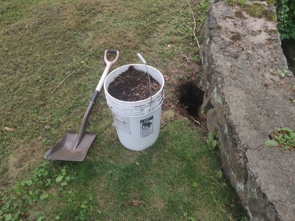

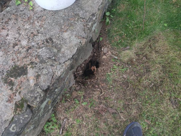

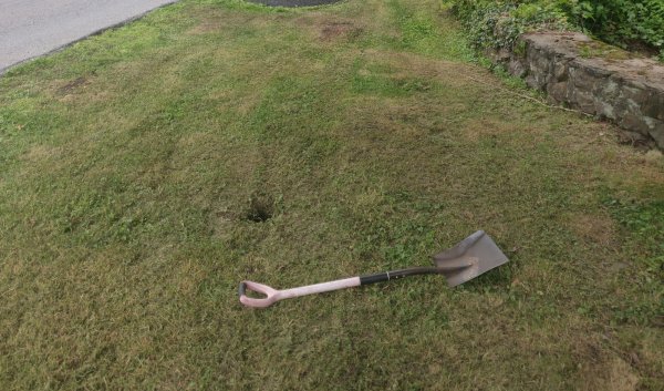

    There were two holes in the lawn. Almost snapped my leg in half when my foot fell in! :bug:Filled it with unprocessed compost.
    Put a little antiseize on the roller wheel bolts as well as the bolts for the pulley cover.
    Anyone remove that black plastic chute on the right side of the mower deck? It just seems to get in the way and I can't see my edge like I can on the left.
    That little strip of grass is not flat by any means.
    Oh yeah and one pulley the grease did come out the other side finally but the other one I think is blocked. I tried heating it up but that just melted the grease and did not free up the clog. I just ended up using an Oregon chainsaw grease tool and pushed it in from the underside to make sure I got some lube up in there. I'm not sure how to remove that zerk fitting - looks like it is built into the nut?
