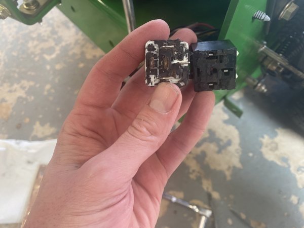

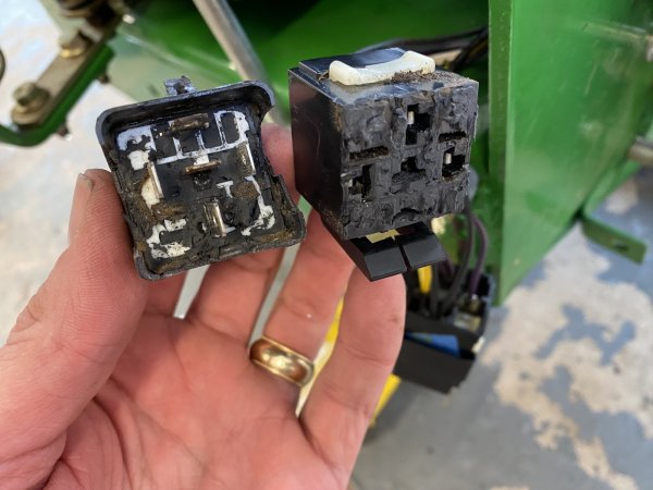

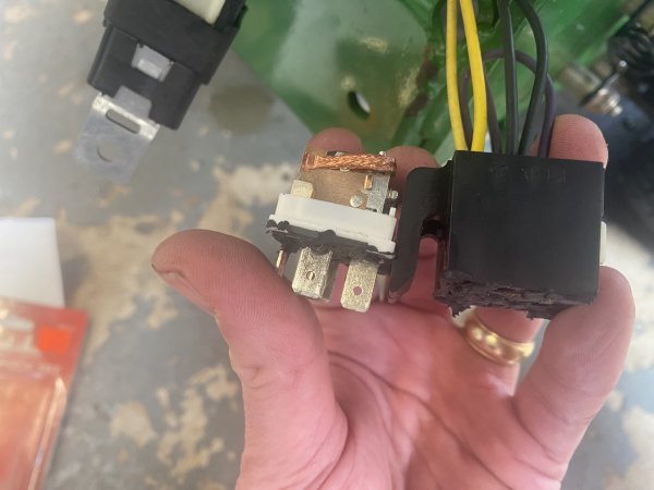

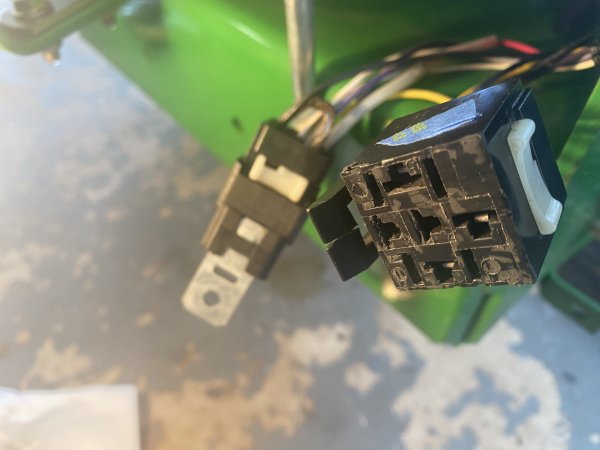

    Had some time yesterday to work on this and figured out why the relays were so difficult to remove as you can see in the pics. Not sure what happened here, but the material on the plug was a cross between compacted foam and rubber. Used a razor blade to clean up the face of the plug and a pick to get everything out of the plug holes.
    I used a little dielectric grease on the new relays when I installed them. The mower fired up just fine. So I then went back to the engine, pulled the recoil and shroud, plugged in the ground and tested it. It worked! All safety switches are back online and I can shut it down with the key.

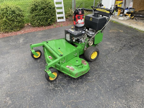

    I had given the machine a wash earlier in the day. Post fixing the electronics, I changed the oil, filter, air filter, pre filter, sharpened the blades and greased everything up. Should be set for the season now. Just need to touch up a few of those spots on the deck where there paint has flaked off.

    General crispiness of the plug/connection...not uncommon.
    Did it seem like all the female terminals made good connection? Often times when the plug is melted like that the terminals have been overheated and the metal has lost its ability to retain "memory", or more simply, the ability to make a tight connection, so it will heat up and melt again at some point.
    If this does happen eventually, you'll probably need to replace the plugs, and likely relays again too, the plugs come with pigtails and you just cut off the old plugs and splice the new to the wire harness.
    Glad she's working for ya though...if it happens again, you got this! :thumbs:

    The new relays seemed to fit snugly. However, I will keep an eye on them, that’s a good suggestion. Thinking of ordering a few extra relays to have on hand just in case.
