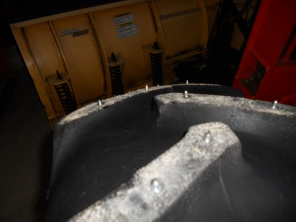

    Naa, just smart:salute:
    From your non food/cat with shooter pics:rofl: :lol:, you've shown what happens when things go wrong with machinery.
    Those screw in studs are a lot more impressive than they look if you ever run into this situation with a customer.

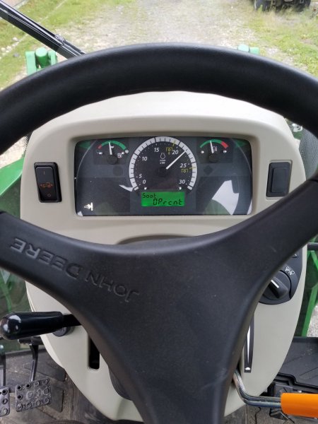

    Laura Jean went into regen!!!!!!

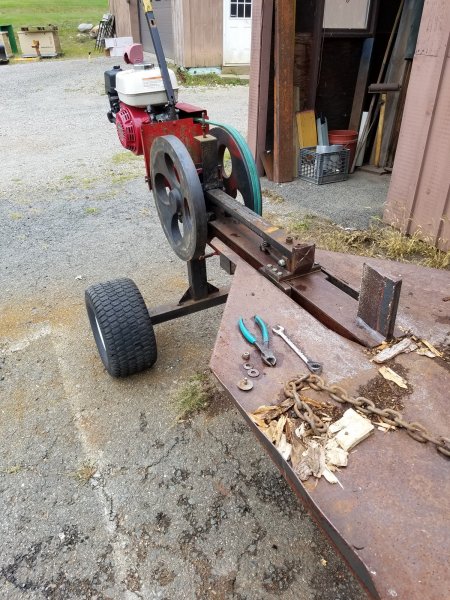

    Washing the super split.....some mice got in there in one week and I started it,pulled the lever and the ram came out slow with a bunch of Hamburg lookin stuff 20180908_164856.jpg

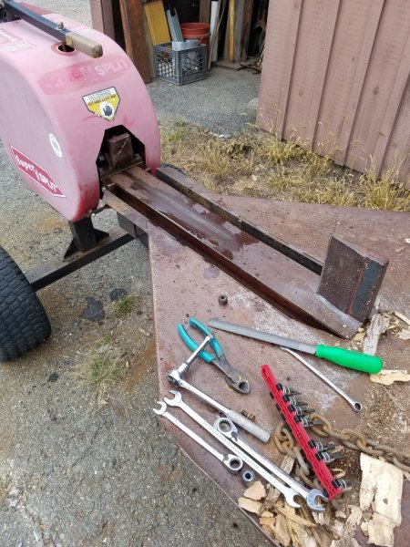

    Pressure washed the rack and pinion,replaced bearing on ram,filed the wedge sharp,and some new hardware for hood. 20180909_085955.jpg

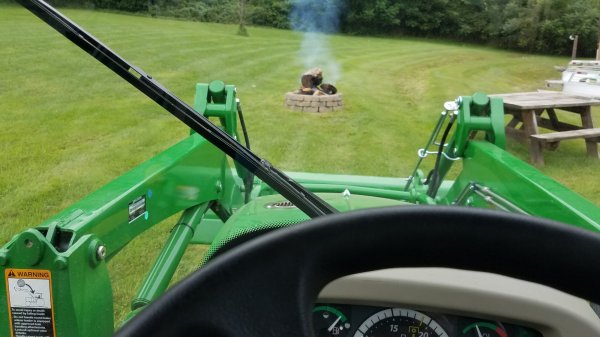

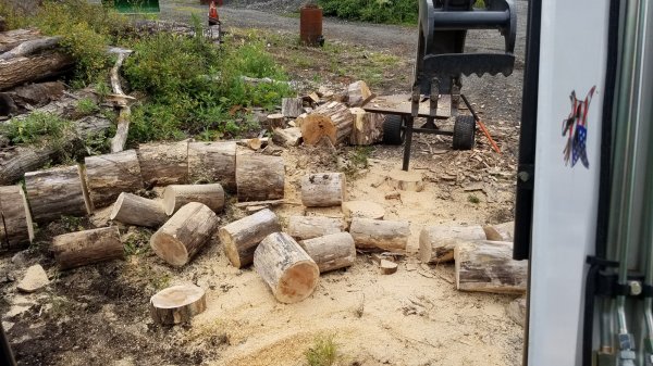

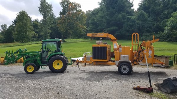

    That chipper makes the tractor look small:)

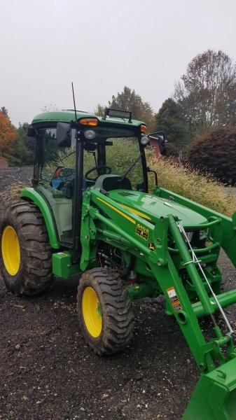

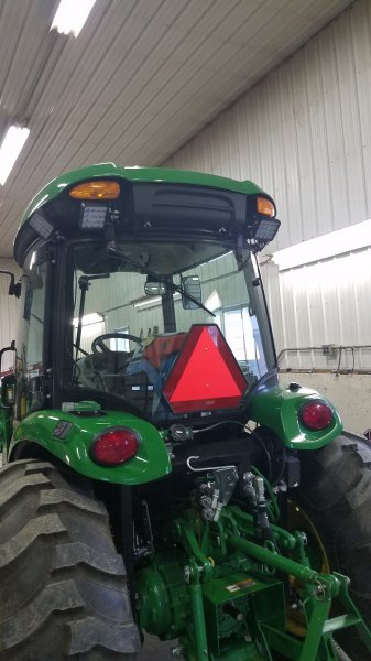

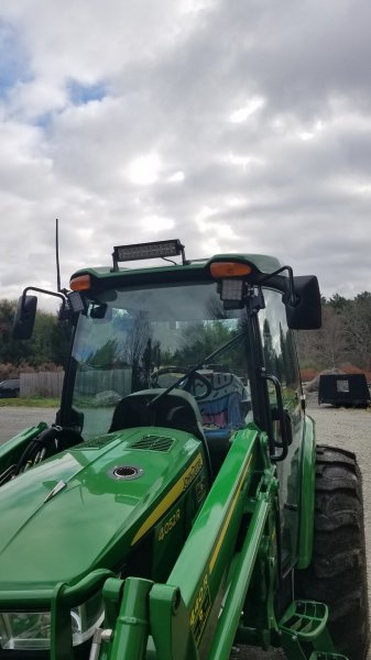

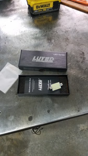

    Looks like you are than ready to take on old man winter!! I put some inexpensive LED work lights on my ROPS a couple of years ago. Makes clearing snow so much easier. I almost exclusively clear snow in the dark since it only seems to snow on days I am working.

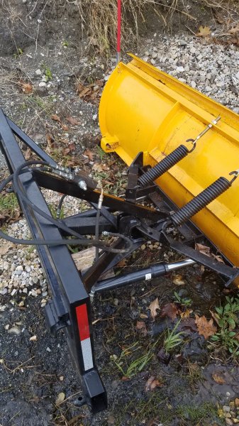

    This is my homemade western plow setup....too much juice comin out the front auxiliary lines,so I took two of the ORB/JIC fittings out of the crossover relief and welded them shut,then drilled a 11/64 hole in em......doesn't slam anymore but still a little fast 20181111_125144.jpg
