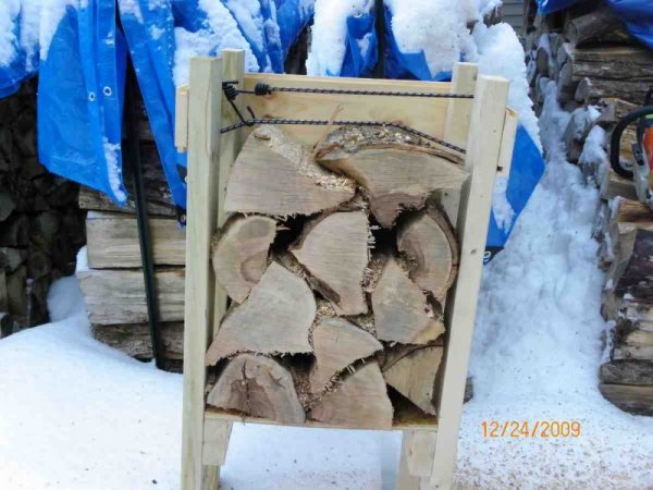

    Uh "somewhere " I saw someone who made a box to trim their wood. He would stack it full of wood and trim a bunch all at once. Something like this
    Timberdog, mat60 and dylskee like this.

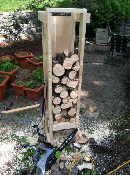

    I have herd of people filling a milk crate , setting it on It's side n cutting the ends off

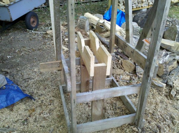

    A small H frame jig is all U need if U R not cutting poles
    Here is some ideas for ya ,Thanks to the people contributing the pics etc., you know who you are :thumbs:

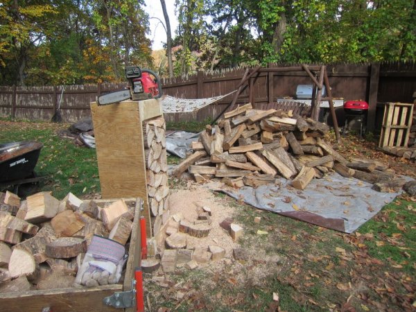

    First one is my version set up for multi tasks
    Last but not least

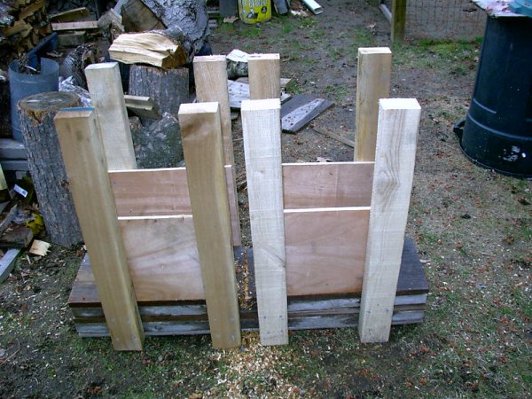

  5. HDRock
    17,162
    59,524

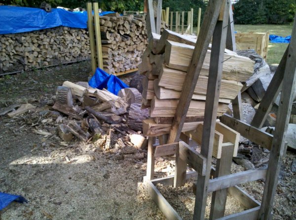

    One more, may be perfect for you

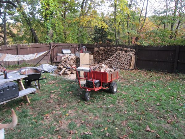

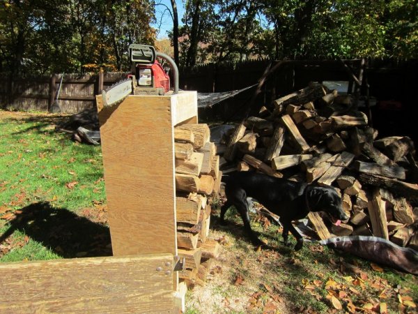

    Well, got my jig built today and got some wood trimmed. It works pretty well, thanks for all the ideas and the help! :thumbs:
    I built it 4'x14"x16" as you can see, the wood hangs out quite a bit......
    Maina, mat60, brenndatomu and 4 others like this.
