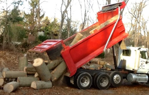

    This truck delivered wood 5 years ago all red oak which I'll burn this winter

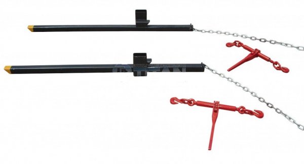

    I first started using these clamp on binder forks. They were cheap and worked well

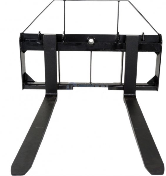

    After a few years I added the QA brackets to the loader arms. I gave the first forks to my brother and got these QA forks.
    Of course I had to modify the bucket to work with the QA arms

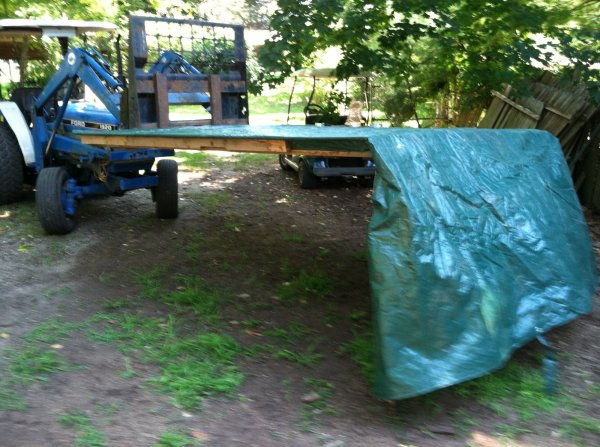

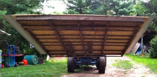

    There's a hot tub store not too far from me and I pick up some of their 8'x8' skids
    I experimented putting 2 sheets of plywood on then covering with metal roofing or pool cover tarp rescued from trash
    Both work very well

    got mine from WR Long - WR Long Pin on Tractor Loader Bucket to Universal Quick Attach Adapter
    They have CAD files for most tractors so they cut and weld them for you. Then you pin onto your forks.
    You still have to cut the tabs off of your bucket and weld on a Skid Steer Quick Attach Plate.
    Best thing I ever did

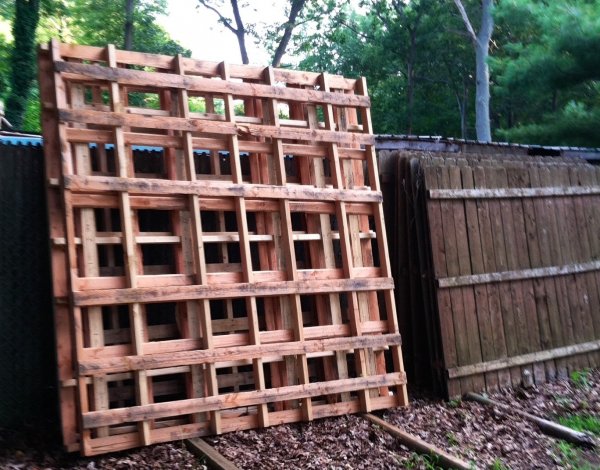

    They have a stack of these skids about 6 ft high. Made of 2x3s and 3/8inch boards
    Could build a lot of things from them.
