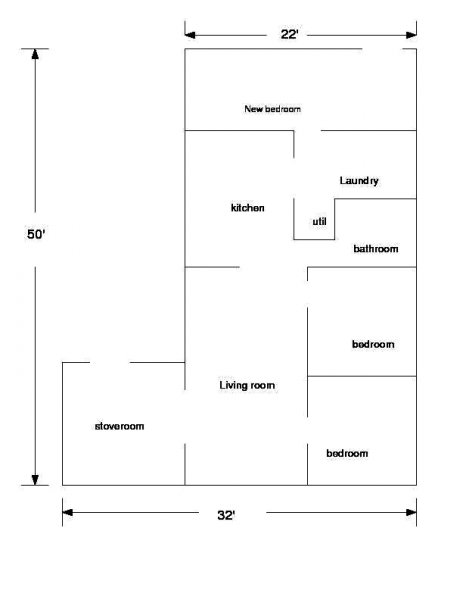

  2. papadave
    Wow, that didn't work as planned.
    That's the house layout, and not to scale, but gives a sense of what I'm working with.
    The wall between the living room and kitchen is a halfwall, so that whole section allows airflow.
    The small bedroom across from the stove room is kept closed most of the time (wife's sewing room), and it's less than 100ft2.
    Not shown is a small window in the wall (old outside wall) between the kitchen and "new bedroom", which allows air through as long as I keep the laundry room doors open, but that room stays in the low 60's and sometimes cooler.
    Stove is directly to the left of the "s" in stoveroom.
    Kitchen, laundry, bath, and util. rooms are all on a small crawl...uninsulated. The rest is slab with exposed block outside. Lose quite a bit of heat there.
    It's not a 2x wide or a manufactured home.

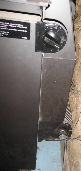

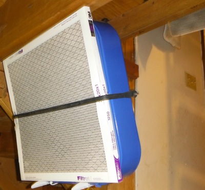

  13. bogydave
    37,220
    I like the variable speed fans.
    Are part of my temperature control.
    Rheostat fan control at bottom.
    Have a filtered fan for moving heat up from the basement.
    My hillbilly filtered/forced air fan. :)
    When I bought, I almost didn't get the fans,
    then I thought why stop short & not get the stove set up the way it's designed.
    I do that sometimes , to save a few $$, then end up back there buying what I wanted in the first place.
    Am real glad I got them . I've used them a lot.
    Probably runs more with the fans than without.
    More evenly heated basement when they're running.
    You may not need them, might work well, won't know unless you have them to try.
    But then again, you can be added later.
    My house is set up a lot different.
    They work well for me.
    BrowningBAR and SolarandWood like this.

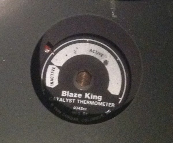

  19. bogydave
    37,220
    Mine don't show temp
    When on 3 cranking with blowers
    3/4 into the active zone
    I had it near pegged when burning a load of limbs 1" to 3" , max open on stat.
    With big splits hard to get it to max out, not sure I can.
    But I try to never leave the stove without setting it down to 3 or less.
    Pic is just now, Hot coals from last night's load still putting out good heat
    For our 33° OAT now. House 74°, to warm, but wife likes it.
    24 hour burns easy at these temps.
