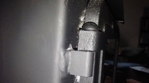

    OK, I inspected the hinges again because someone thinks the door is up too high on the stove. It appears the top hinge may be welded too high. Look at the photos and see what you think. I will label which hinge is which for the photos. I will send these photos to ESW and see what they say.
    First photo is the top hinge; notice how the door part of the hinge is sitting flush with the stove part of the hinge.

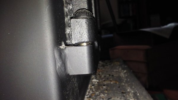

    This is the bottom hinge. Notice there is a gap between the door part of the hinge and the stove part of the hinge. This may be all that is needed for the door to hit the damper knob.

  5. papadave
    Hmm, it does look like the top hinge is holding the door up.
    Maybe someone got a bit lazy when placing the jig while the body hinges were being welded.
    Without knowing the exact procedure, it's all conjecture.
    concretegrazer likes this.

    Also looks to have a bit of a burr on the bottom of the door side of both.

  9. Eric VW
    24,581
    141,840
    Based on this pic-
    You could eat down a little of the [bottom surface of] top hinge....or not. That’s what I would do, 5 minutes and done.

  12. Kimberly
    Kimberly
    Mar 19, 2015
    5,072
    12,819
    The Kangaroo State
    Yes, I could ground down the top hinge; making it less tall, the amount of the gap at the bottom but that is outside the fact that ESW's worker put the hinge on in the wrong place.
  13. Kimberly
    Kimberly
    Mar 19, 2015
    5,072
    12,819
    The Kangaroo State
    Looking at the amount of the gap on the bottom hinge, I would not say a little. In the photo; have not took a scale to it yet as the stove is hot, that gap appears to be significant.

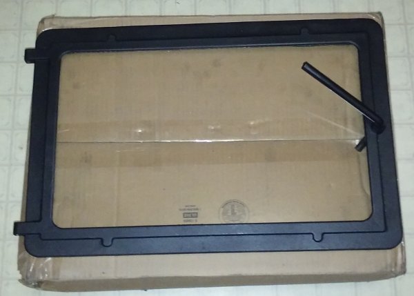

  17. papadave
    Here's what may be the simplest "solution".......grind down enough of the top of the door to clear the rod. Make it nice, repaint, and call it gooder.
    I doubt pulling a bit of material off there would compromise the integrity of the door.

  19. huskihl
    huskihl
    Jan 30, 2016
    3,728
    21,489
    Is it possible to bend the lever up out of the way? Like slip a cheater pipe or box end wrench over the end?

  20. Kimberly
    Kimberly
    Mar 19, 2015
    5,072
    12,819
    The Kangaroo State
    Take a look at this photo again. That would be a large grove in the top of the door to accommodate the spring knob.
