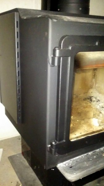

    Can we see a picture of the side of your stove with the hinges?

  11. Kimberly
    Kimberly
    Mar 19, 2015
    5,072
    12,819
    The Kangaroo State
    Here is the requested view of the hinges.
  12. CoreyB
    CoreyB
    Oct 27, 2015
    1,043
    3,421
    South east iowa
    I didn't realise the 02 had a step up on top like the 30. Interesting
  13. brenndatomu
    25,097
    163,039
    I think almost all modern stoves do...it looks good, but the main reason for it is structural, it keeps the top from warping easily while going through intense heating and then cooling cycles...

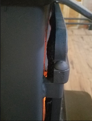

    I just read a report (and saw pics proof) of another Englander stove (that "other" forum) that pretty obviously has the door welded on in the wrong spot, well, actually more like the wrong hinges welded on...and it sounds like this is not the first report of such non-sense just recently either...wonder what's goin on at ESW? QC get a layoff?! :confused:

    17,262
    60,487
    That stove is really messed up
  16. concretegrazer
    concretegrazer
    4,429
    12,455
    Southwest MO
    That's just crazy.

  17. HDRock
    17,262
    60,487
    I read some others over there , hinges are not right

  18. bocefus78
    bocefus78
    Oct 14, 2013
    3,694
    19,840
    Indiana
    Whiskey. Tango. Foxtrot. I'm not sure what's more jacked up. Those hinges or the guy who thought it'd be okay to light that thing up?
  19. yooperdave
    35,696
    224,202
    Those hinge pins almost look like they aren't quite lined up!

  20. CoreyB
    CoreyB
    Oct 27, 2015
    1,043
    3,421
    South east iowa
    Wow that is very bad!
