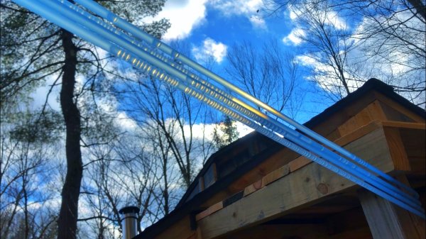

    Started tapping yesterday and kept going today. Taking a gamble on the weather this early in February but right now the sap is running hard and fast! Looking to fire up the arch before sunrise on Wednesday morning.
    Few pictures from yesterday and today.

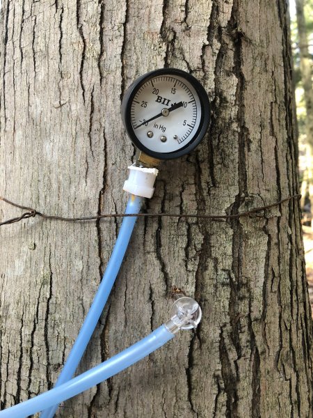

    It’s a vacuum gauge for 3/16th tubing. In 3/16th diameter maple tubing, the smaller size (compared to the more commonly used 5/16th tubing) creates a natural vacuum in the line provided you have an elevation drop. The greater the elevation drop between the top end of the line and the bottom, the greater the potential for creating a natural vacuum. The gauge in the picture is for a line that drops over 70 feet from top to bottom. I believe 50 feet is the target for pulling 30 in Hg. After I completed tapping today I went back and checked all my 3/ 16th lines to make sure everything was running smoothly. Had to find and fix a leak in one line (squirrel chew that I missed when walking the lines to look for damage). I have a couple lines below the sugar house with a much less dramatic elevation difference. 25 feet between top and bottom on one like and I see natural vacuum cut in half to about 15 in Hg (compared to the 70 foot drop line). The vacuum helps get the sap down the hill faster and helps you collect more from each tap over time. A lot of producers with larger set ups run electric vacuums to achieve vacuum in their lines.

    Thanks, great info. Using nature, I like that.
