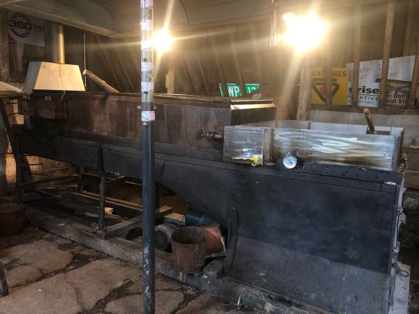

    C1A49D60-67C8-4B1D-B633-9B3F8F07653C.jpeg Finished up gathering 2000 gallons or so of sap this season.
    Picked up this old school evaporator yesterday for my buddy. 10x2.5 Lightning by Small Brothers. Should be a cool project for him and a big upgrade production wise versus his 2x4 he has now.

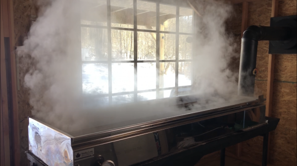

    Last weekend I started cutting in new drop lines and taps on our 3/16ths lines. Plan to keep going with that this coming weekend. Have to get all our buckets and tanks cleaned and ready, too. This year we’re running 34 bucket taps on trees below the new sugar house. 140 taps on tubing above the house, flowing directly into our main collection tank. Really, really looking forward to the reduced work load hauling sap around. We’re single tapping all our trees - even those at 18” +. Need to figure out how much additional sap production we can handle given the potential for increased boiling time in the new sugar house. If we find we can handle it, we’ll add additional taps in-line at our larger trees. That’ll push our tap count up over 200 on tubing if we do. We’ve also got 50 beautiful sugar maples in reserve further up the hill that can be added in if needed. I’m thinking those trees won’t be added in this year. Too much volume I think. However, next years planned maple project will be to build an RO unit. So that’ll be yet another year of figuring out how much we can handle in our setup.

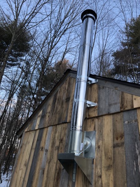

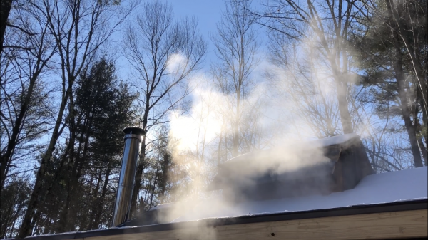

    Fired up the arch for the first test fire earlier this week with the new chimney. The draft in the chimney happened instantly. Super happy about that. Steam from the pan draws out the cupola nicely. Just need to figure out what I want to tack up on the ceiling to keep the moisture away from the wood as it’s rising up. Any suggestions for what to use? Preferably something budget. At least for now.

    Just need to figure out what I want to tack up on the ceiling to keep the moisture away from the wood as it’s rising up. Any suggestions for what to use? Preferably something budget. At least fornow.
    Woodsman , best thing for that steam issue is a hood. Not sure what your roof sheathing is but if it’s OSB you don’t want that dripping back in your syrup . I’ve seen some makeshift hoods using aluminum and pop riveted together . Stainless is best of course . Another advantage with a hood is you can put a preheater in it and increase your boiling rate 10% or so . On my rig Sap is about 38-42 degrees going into preheater and coming out it’s around 170 degrees . That’s free heat !

    Budget minded fix? A thicker mil plastic drop cloth. Menards has 'em for around $4. 9X12 4 mil. If you do go that route, use some wood laths (stickers) to attach the drop cloth to ceiling as opposed to staple gun. Once the condensation starts collecting, the drop cloth will become heavier and may pull out of the staples. Of course, position the drop cloth so it will shed condensation back and away from the tank.
    wishlist has the best idea with the stainless hood though....:makeitrain" Maybe in the future? Maybe some used equipment out there for sale? Closed restaurant?

    Most definitely want some. Your sugar house looks good, that new stack looks great. Hope you have a great season.

    I was thinking I’d try to get away with a budget option to deal with the steam this year but after some hard consideration and talking to my wife last night I think we may put a little bit more into the operation this season and get a hood. Making a phone call about that this morning. Get the ball rolling on it. Thanks for all the advice, wishlist!

    I just got off the phone with the guys over at Smoky Lake in WI. We bought our 2 x 6 divided pan and feed pan from them last season. They can get to building the hood within 10 days and then put it on their semi to head this way in 3-4 weeks. Hood fits exactly over the pan and comes with 6 feet of stainless 10” stack pipe to vent through the roof. Free shipping. Bit more than we wanted to spend this preseason but I figure it’s a necessary piece of equipment that will have to happen soon anyways. If not this year then next. My goal is to grow our operation a little each year - so this year we grow a little more than expected. I really like that I won’t have to worry so much this season about excessive moisture buildup on the wood and sheathing in the sugarhouse. Until the hood arrives, I guess I’ll attach some rolled plastic sheeting to direct the steam up to the cupola - as was suggested in a post above. Couple weeks of that is no problem to deal with.

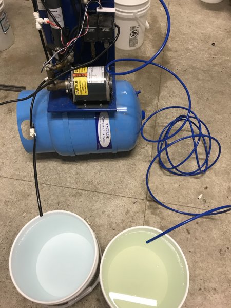

    Tonight I am working on a RO system for this year. It’s looking like it will evenly separate ~ 8 gallons / hour. I was hoping for more but we’ll see how it does on sap and go from there.

    Nice - I built one several years ago and was pleased with it (only used it that one year, and have had multiple years not sugaring since then). I had three household water membranes in series, and was dumping the concentrate back into the same container I was feeding from.
