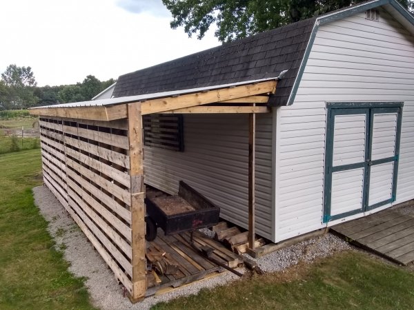

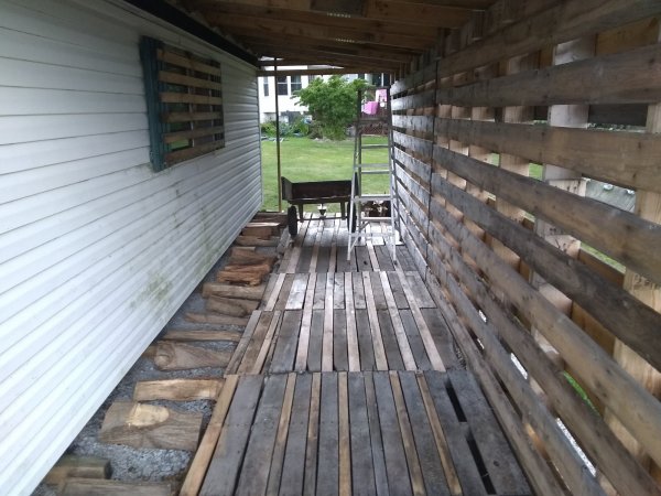

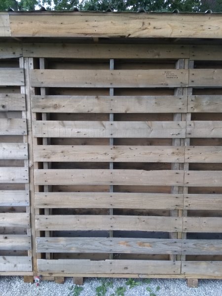

    Well, I didn't get it done last year...just finished up last Saturday evening...pounded the last nail by flashlight.
    This shed got strung out over such a long time period I kinda lost track of the exact dollar amount spent on it, but its certainly less than $200...all the wood was reclaimed (same stuff I used on my shed) and same steel roofing I used too...the main things I bought were screws and misc fasteners, glue, caulk, earth anchors, etc. It still cost me plenty of my free time though.
    The shed is 24' long (same as the barn) and about 7' wide inside...should hold almost 8 cords if they stack to the ceiling, or about 2 years worth. I made a door of sorts in the middle that can be popped out if needed to access the driest wood... that's what I'm showing in that last picture.

    Nice work Dave! :thumbs: You take a lot of pride and it shows in your workmanship.
    I must ask though...looks a little low??? How many times did you hit your head?
  6. brenndatomu
    25,314
    164,807
    Thanks!
    Yeah that pic makes it look that way for some reason...but its not low at all...my nephew is 6' 8" and will most certainly be involved in stacking wood in there, so I made it so that he clears, even with his work boots on.

    I think it's an optical illusion. Most of those type of sheds are about 5' tall at the point where the wood shed's roof is. The original shed's door gives you the real height.

    After i asked i used the stepladder for reference. Steps are a foot apart.
  9. brenndatomu
    25,314
    164,807
    This barn has taller walls than many of the smaller ones do...the barns doors are full height doors too.
    That horizontal 2x4 at the end of the shed there is 6'10" from the pallet surface.
  10. brenndatomu
    25,314
    164,807
    That's using the ole kidneys! :thumbs:
    Yeah that's a 6' ladder.
