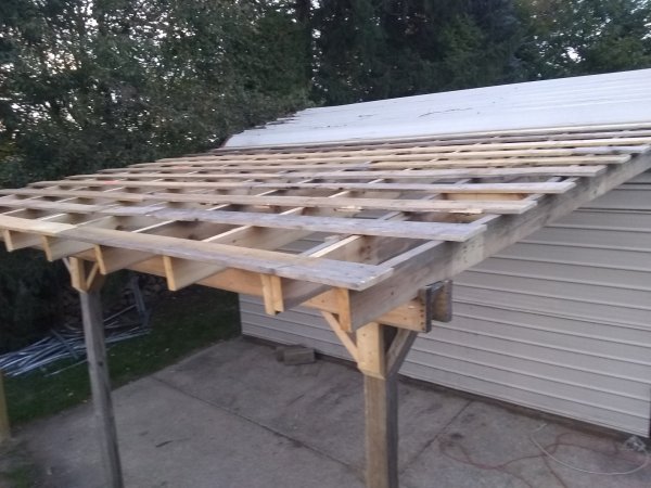

    My preowned roofing has screws holes at about 25-26"...I really wanted to reuse the existing holes, but thought there needed to be purlins more than every 25-26"...so I went every 12-13" or so...plenty sturdy enough to walk on once the roof is down...I was a little surprised how much nailing these down stiffened things up...and speaking of nails, even the nails were "preowned" for this part of the project...seems like about 1/2 of the nails come out fairly straight when I demo the crates that this lumber came from...I have enough ring shank nails to fill a 5 gallon bucket! (not kidding!)

    Making good progress BTU! Yeah the sheathing or strapping really stiffens things up and ties it together. Dont blame you on the nails. When i take stuff apart like that i do the same. Go buy a 1lb box of 8d nails and youll see what i mean.
    Silicone or any acrylic latex caulk with silicone will seal any holes up okay. Polyurethane caulk is great too. Just make sure its clean before you seal.
