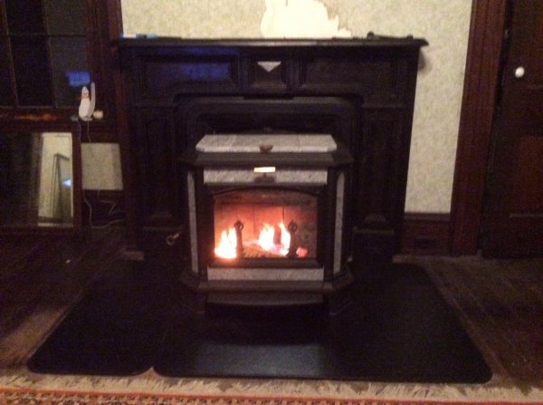

    image.jpg I wish we could have gotten the ash pan option but our firlace opening is too small. That being said, how do others handle ash without the ashpan in a PH.

    My set up is similar to yours so I couldn't get the ash pan otherwise I'd love to have it. The thing you have to watch out for is since the PH is wide and you're cleaning from the side door the ash can tend to build up on the side opposite your door. I make it a point to drag that ash towards the door and shovel it out. I take advantage of warmer days to clean it out good and prepare for cold snaps so I have plenty of room to load it up with wood.

    There is nothing terribly unique with the Progress to handle ashes. The PH tends to efficiently burn down the coals. Make sure (at the end of each burn) the ashes don't cover the small anti-burp hole below the window. Once down to ash, like any other stove, stir the ash/coals to settle the volume until there is so much ash it's time to empty.
    Carefully shovel out the ash and gently drop into pail trying not to cause dust to form. That's the tricky part, it takes major patience and a steady hand to remove ash without stirring up an ash cloud which unfortunately coats things in the room. I was never able to get that part down very well, I'm just not steady and patient enough to prevent the dreaded ash cloud :bug:.
