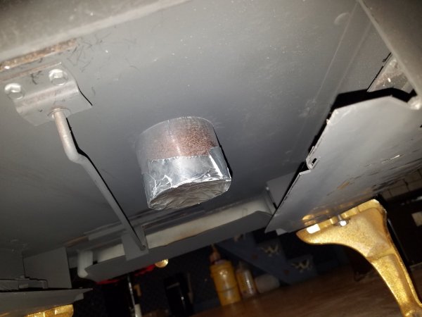

    I rolled it up tight with some cement and stuck it up from underneath the stove.
    Here is a pic from the floor of the ash clean out on the bottom of the stove with the plug I made. It is not replacing the ash plug it is about a 1/2" below it. I just thought it may block any air if the plug is off a bit.

    Check that plug for leaks then. Could be more than one.

    Yeah, that's prolly not leaking...could wrap some aluminum foil around the bottom of that plug as one more line of defense...could maybe tie some wire around there to encourage it to co-operate/stay in place/seal too...
    HDRock, Marvin and Maina like this.

    I was getting ready to grab some tin foil then I remembered I had some foil tape left from my liner insulation....
    I can't imagine that thing will be leaking anytime soon.
