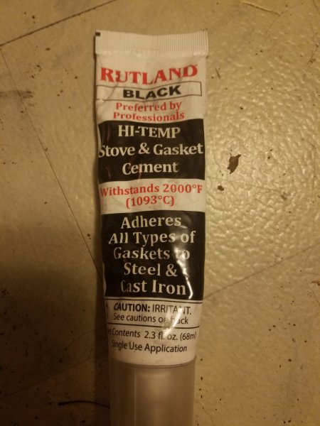

    The stuff I got said it is rated to 2000*. I didn't look to see if it said cement or silicone on the tube but it came out like silicone.

    Still have it? I’d be interested in knowing what that is. Always interested in a better mousetrap.
  8. Marvin

    Yep I still have it. Now that I look at it I see it says cement. Here is a pic...

    Yep, that’s the old mousetrap I use ;) :) Good stuff IMO.

    Yes it is the baywood door. I replaced the outside glass gaskets while I had the door gasket off. I will replace the center glass gasket when it comes (did not realize it takes 2 kits to do all 3 pieces) along with putting on the 7/8" door gasket. The baywood door made it kind of a PITA to reset the glass properly but I love the look of it.
    The rutland tube said to close the door for an hour while it cured. I didn't close it real tight though.
