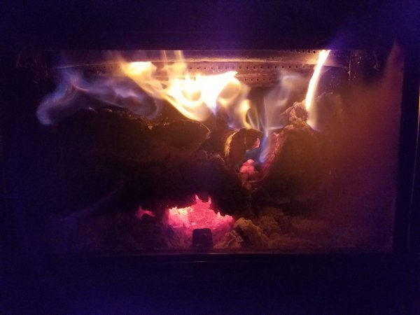

    I loaded up the stove and started closing the air fairly quick not knowing what to expect. I almost smothered it! Went outside and smoke was billowing :hair:
    Back in the house and opened the air. Fire came back and started slowly closing it down in smaller increments. Got the air where I want and we've been cruising at about 700* STT for 15 minutes or so. Nice secondary burn, no smoke coming from the chimney :thumbs:
    I feel like I will have so much better control once I change this gasket.

  12. brenndatomu
    25,361
    165,216
    That looks hawt ;)

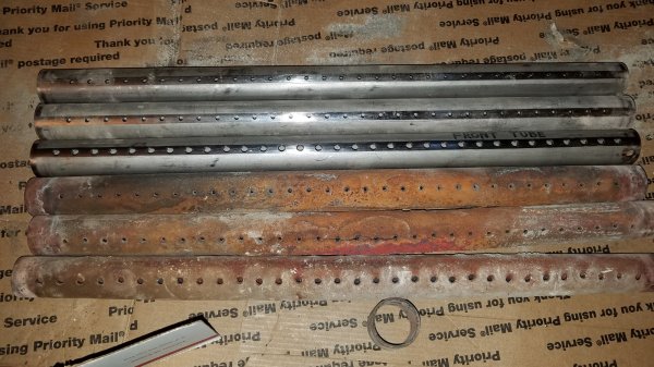

    I had a door gasket leak one time that The dollar bill test or the smoke test would not reveal , The leak was because The gasket Was coming loose where it is at Adhered to the door .
    I wouldn't worry about the tubes glowing red They do that all the time

    The do, but if you get them too hot, they sag.

    Then you get shiny new ones -wood-stove.jpg :)
