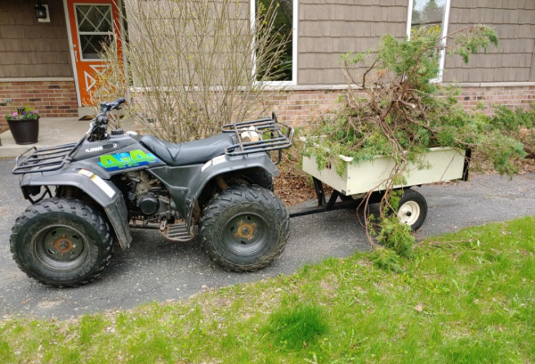

    Here's mine from like 2 years ago, with the newer bigger tires and wheels.
    Iirc they are like 11" and most use 12" rims now.
    They are a common bolt pattern though and new kawis use this. 4x110 off the top of my head.edot...
    4WD, 89-05 (F) 24x8x11 4/137 front
    Bayou 300 4WD, 89-05 (R) 24x10x11 4/137 rear
    Use this chart, you'll see newer bigger kawis use the same 4x137 bolt pattern. mine were from a brute force 650 iirc and 25" od tires. 1" lift this way and gets rid of the odd 11" wheels. But now I have to have the rest tire chains tight or they clip the metal stay on the foot guards.
    Kawasaki Tires and Wheels Application Chart

    No issues with the 4x4 with different tire sizes??

    As long as you keep the front to rear "ratio" the same, shouldn't cause trouble. I upsized the tires on my Grizz and there was some binding on dry pavement...I played with air pressures until it felt about the same in 4x4 as 4x2 (on dry pavement) which is probably better than 99% of the quads out there with stock sized tires...due to people not paying attention to tire pressure and as I'm sure you are aware, a couple PSI difference in a 2 ply tire can make a big difference in overall diameter.

    They all went up 1", so no issues
