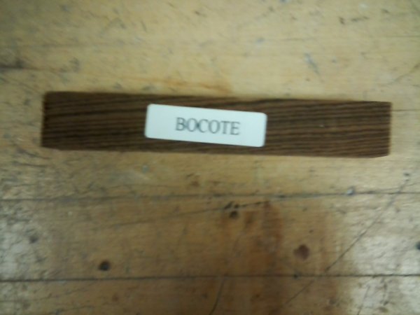

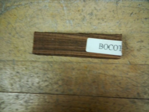

    Greenstick, your pen is completed. I have taken pictures, (I still have a flip phone) so send my pictures to my oldest daughter and she is sending them to my email account at home and then I will get them posted. I actually used it for a demonstration for my advanced turning class as the bushing is a sliding bushing and they have not encountered that type yet so was a good opportunity. Everyone that has handled it likes it, the two girls in class have small hands and it is to large for them to use comfortably. So here is hoping it is large enough for your hands! I actually bought two kits, in the event you don't like this one, I can build the peanut shaped pen that you drew from a single piece of wood using this kit.

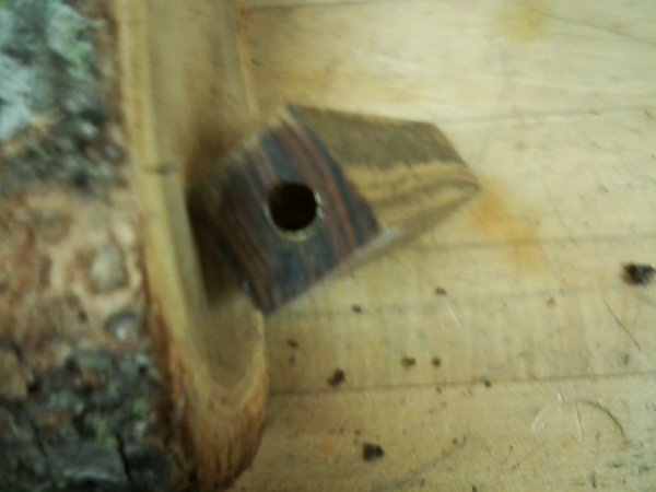

    This is your original bocote wood pen blank.

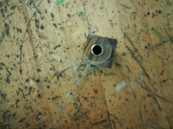

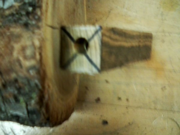

    Then I cut the blank to size, drilled it to size and glued in the tube.
    This is what they look like from the end view.

    Alright, we left off with the tube drying in the blank. Now we need to "barrel trim" the ends of the blank down to the tubes so we have a full 90 degree edge at both ends of the tubes so when we assemble our kit, the wood fits flush all the way around the pen to the attached metal parts. So here is your pen blank with the ends barrel trimmed.
    and the other end.

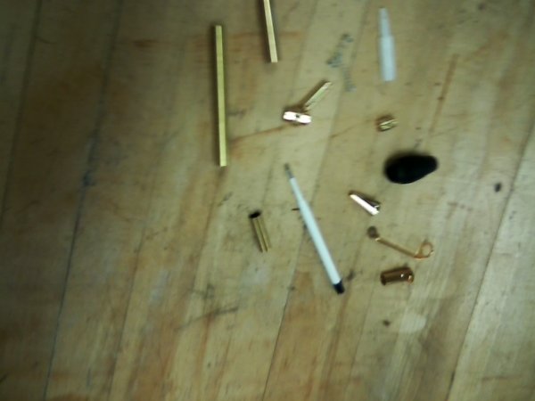

    And here are all of the parts to build your pen.

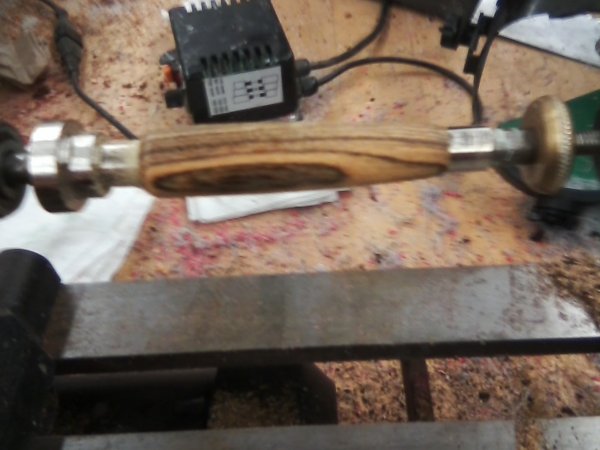

    Here is a terrible shot of the lathe with your pen on the mandrel while being sanded.
    And this is your pen blank after sanding before polishing.

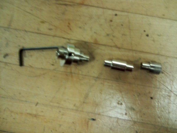

    Okay, in order to get the wood to the same diameter as the metal parts that make up the pen kit we use bushings. The bushings are specific to the pen kit being built. In the above photo of the pen blank on the lathe it is on a mandrel which is a shaft that everything lines up on and allows us to turn the blank down to size. Here are the bushings off of the mandrel.

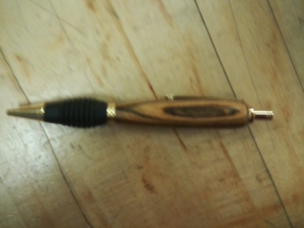

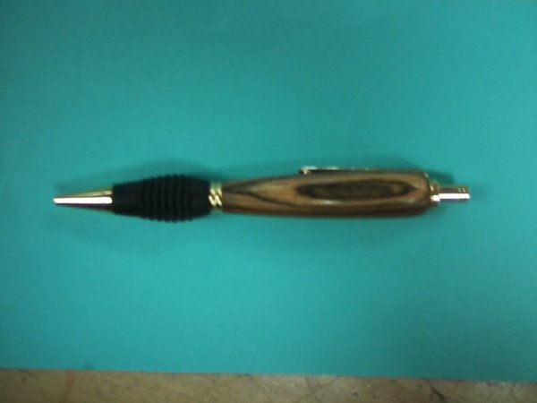

    Here is a terrible photo of the completed pen.
    Here is another photo, less terrible than the first one.
    And there you have it. Your completed pen. It is a nice writing pen. I like this kit, I will be making more of them for sure. I got your pm and will be replying and all that jazz later on today. Sorry about the photos, I am not a photographer! It was nice documenting this build here for you. Jon

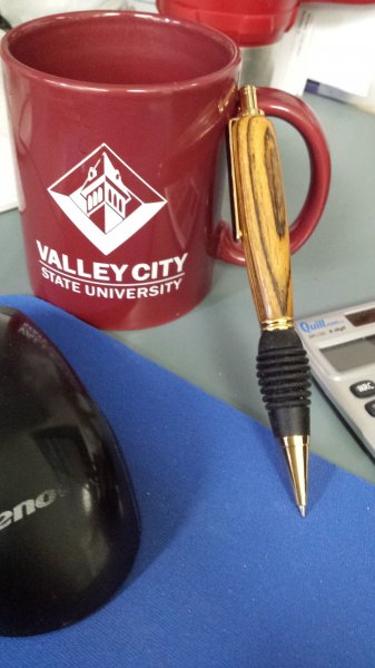

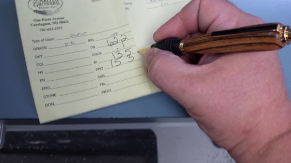

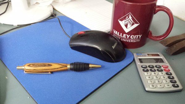

    I LOVE! how this thing feels, writes and looks. What awesome work you do! 20170908_120546.jpg 20170908_120810.jpg 20170908_120906.jpg

    Now there are great photos!!!!!!!!!!!! So glad it fits your hand and is what you wanted. :yes:
