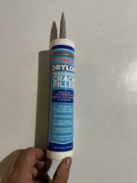

    I had the copper 4” stack replaced quite a few years ago with the PVC and he connected it to the old iron pipe in the ground with that black rubber drain connector. It worked fine but in the last 1.5 years it looks like it started weeping a bit so I had the same thoughts using something that was made to seal concrete. So I just picked this up, see pic
