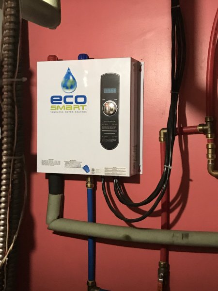

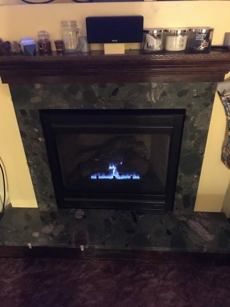

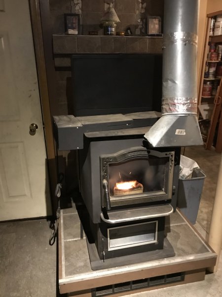

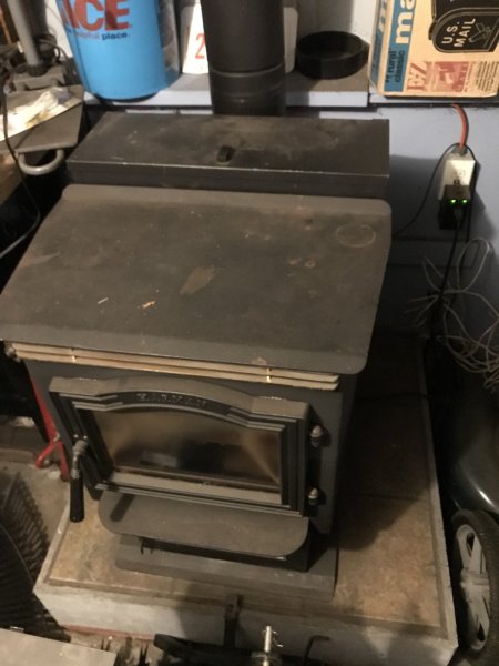

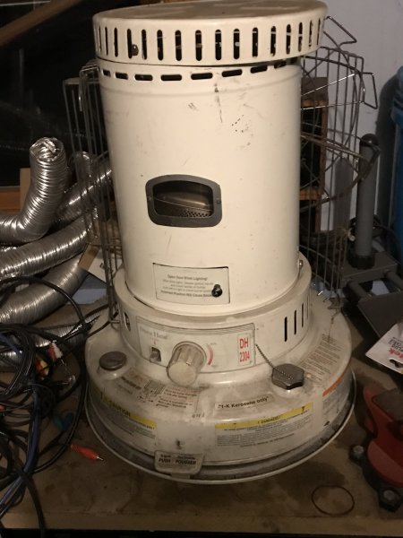

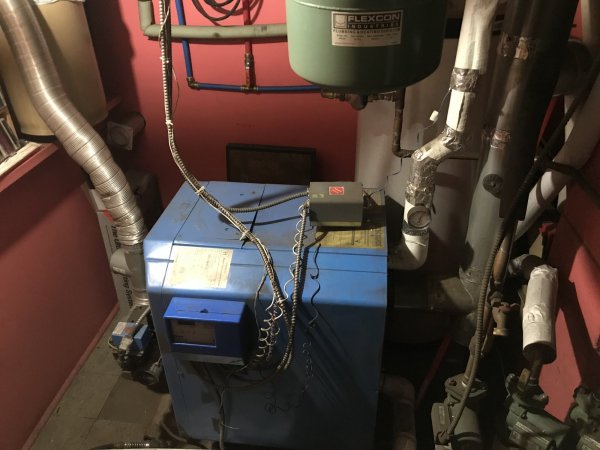

    Pic 1 - Basement P61a
    Pic 2 - Backup P61a in garage that can still heat the house
    Pic 3 - On Demand electric hot water panel for hot water
    Pic 4 - Backup Buderus boiler for backup heat or backup hot water
    Pic 5 - propane fireplace for backup heat in case of a power failure
    Also note the 900 watt electric kick space heater built into the basement pellet stove raised hearth
    and the hydronic kick space heater built into the propane fireplace raised hearth in the livingroom.
    Pic 6 - Last but not least, good ole stinky the portable Kero heater to use wherever needed. :)
    The above does not mention the workshop and shed pellet stoves either. :)
    Luneyburg, bogieb and ChandlerR like this.
