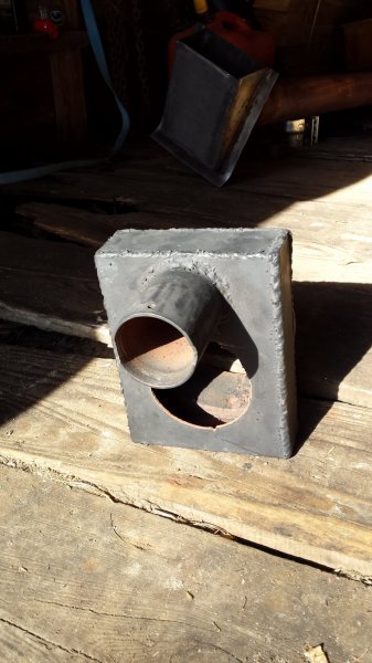

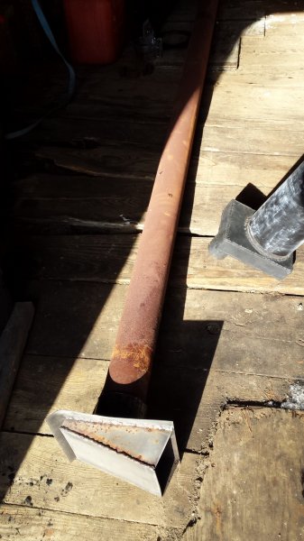

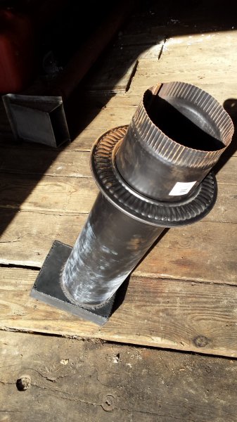

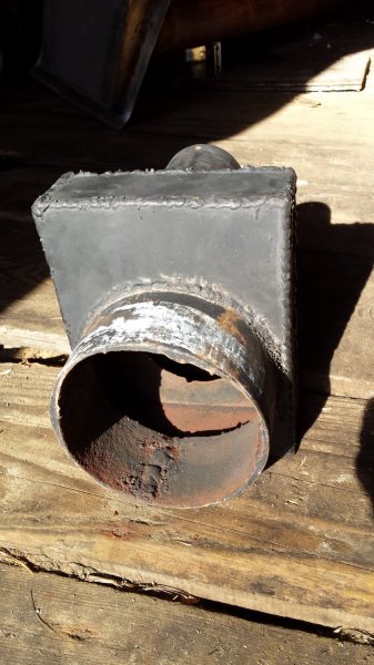

    The venting went as a straight 1/4 × 4" x 8' solid pipe for exhaust. Then 6" black stove pipe wrap around the exhaust pipe for OAK. The black fabricated gizmo is attached to the air inlet of the furnace and the big hole is for the exhaust pipe to go through and the black stove pipe attaches on the biggest hole.

    Going back into who installed this?
    The seller purchased the place with this set-up already installed.
    It was a new Fahrenheit furnace in the living room which the wife wanted removed for more space so she says:rofl: :lol:.
    I would of never chosen that kind of stove but that's me.
    It isn't pretty for a stand alone unit like you can get everywhere(probably was a door to door salesman:smoke:)
    With this gizmo set-up, I can only guess it was a dealer installation.
    Strange one indeed but it was functional and would of needed vent cleaning more often.
    Insurance & WETT inspection, no clue what was going on behind closed doors:whistle:

    I was wondering how it passed a WETT installer but guessed it was like all things involving people, insurance usually relies on self certification, you know, was it installed by a ........................... (fill in the blanks).

    Hey LW what do you think of the fab work?

    I think, while it worked, it certainly has got no UL listing, therefore, were a fire to happen, he'd be $crewed, insurancewise

    Those adapters look like what the oil tech folks offered as an install option on the FHA oil furnace when we had it replaced last (circa 2000), to allow for OAK / direct vent to outside.. Said it would make the furnace "5 to 10% more efficient", IIRC.. They would have built the OAK / flue run on-site.
    Like this one.. (It may have been this same kit, too many years/too many Beers.)
    http://www.thermopride.com/wp-content/uploads/2014/09/46483500-Field-Direct-Vent-Oil-Kit.pdf
