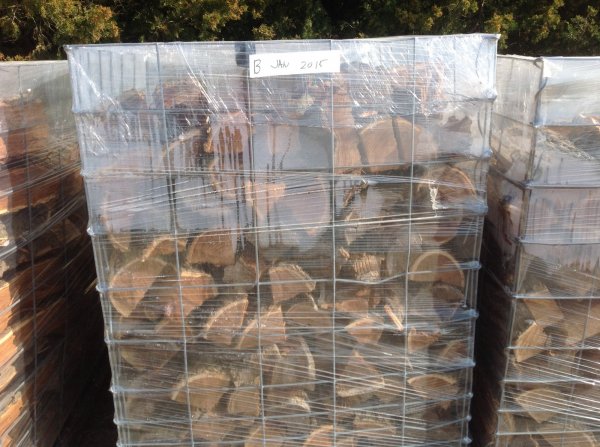

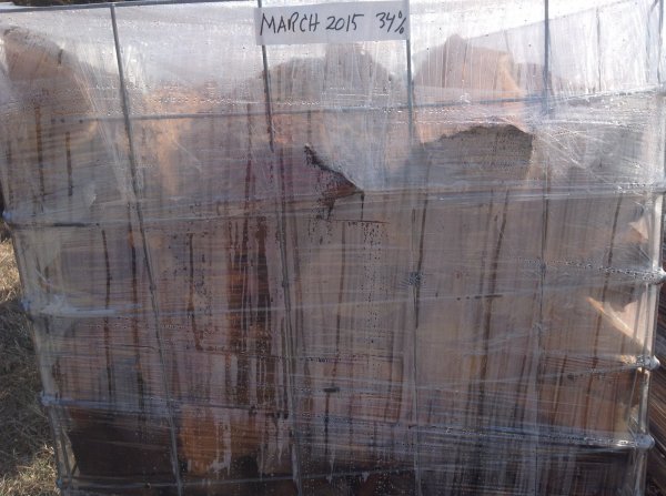

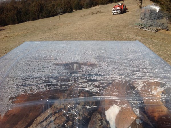

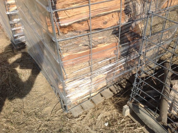

    Status from today. Sunny , dry & 70 degrees.
    image.jpg Above is green Mulberry css'd January. 34%. 16 inch for inside fireplace.
    Below is green Mulberry css'd yesterday 34% 24 inch for OWB
    I am even getting some good drying down low. Open bottoms on my pallets. I am sure that it is cooler down low.
    Finally , top of freshly css'd Mulberry.
