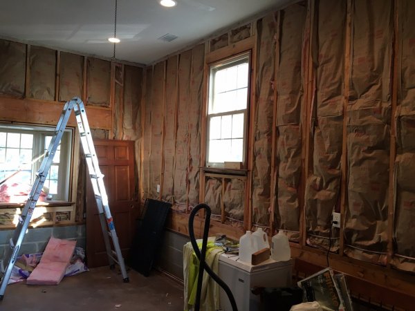

    In these two pictures would it be ok to just fill in the small to medium areas around and under the windows with that canned foam stuff instead of cutting insulation to fit?

    That would work fine. Just make sure you use the low expansion foam meant for windows.

    Matt, I did that in a couple narrow stud bays, but it takes quite a lot so buy a bunch of cans. At close to $7/can, it can add up pretty quick.
    I did one bay floor to ceiling that would have been a major PITA to use batts, due to the way the wiring was done there. It was only about 4-5" wide.
    In the 1st pic, I'd use batts, but you could foam the small bays in the 2nd pic.
    Be aware that you don't want to try filling the whole cavity at once. It'll take about 2-4 layers to do it. If you do too much, it'll just sag and puddle out.......ask me how I know.:headbang:
    Between the window frame and the wall framing, definitely use the window/door stufff.
    Eric VW and mattjm1017 like this.

    Yeah I intend to use batts in all of the cavities except like you said the small bays under the window in the second picture.
    We would like to replace all of the windows in the house next year if I spray foam the cracks around these windows would that make it a major PITA or impossible to do in the future?

    It would not be impossible but ......
    If you're replacing windows so short time away, just use the fiberglass for now.
    The spray foam I've used is also an excellent adhesive!

    The plan is to get them all replaced next year hopefully that will work out. Ill keep your advice in mind and avoid foam around the windows. Thanks for the heads up:yes::handshake:

    A Sawzall would make short work of any foam. Just run the saw around the window/door frame. It'll require some foam scraping, but I HATE using fiberglass around doors and windows. It invariably allows air in.

    Very true. The fiberglass finally ends up acting more like an air filter more than anything. But using it sure makes for easier removal with little to no damage to old windows...making them easier to get rid off (re-sell, donate, etc)

    Were going to tear out the old insulation today and try to get started on the install of the new.

    Got the new stuff in still need to staple most of it and put in the foam around the Windows.
