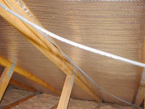

    Here is my story.
    I have a split Entry home built in 1962
    A. Save heat in winter by insulating Attic Floor better and closing up gable vents

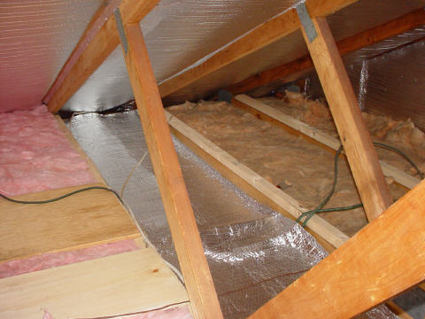

    Pic 1. Rip 2x4s down to create 2x2s and nail them to the 2x4s.
    Remove OLD R7 Stamped ECONOMY Owen Cornings Fiberglass Paper Faced Insulations
    Pic 1. Air seal all holes with Can Foam
    Roll down Reflectix Foil R3.9 then roll down R19 Fiberglass Paper Faced Insulation on top of Foil
    Pic 2. Criss Cross with Unfaced R30 Fiberglass insulation for a tolal of R53 in floor!

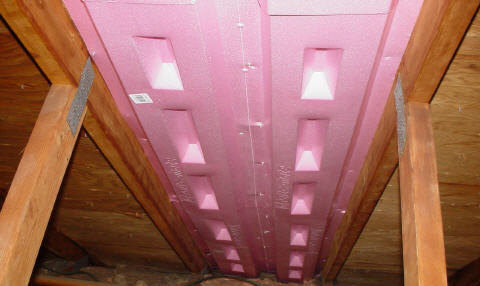

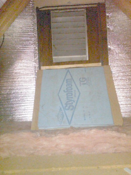

    Pic 3. Since I now have a Ridge Vent and Soffit Strip vent I built doors to close gable vents in Winter
    Also insulate and foil Gable Vent End Walls for better insulation. amazing now by doing tha the paint never peels in the outside triangle where gable vent is because there is no extreeme temp diff between inside and outside!!
    Saves a tremendous amount of heat being sucked out of the house from cold winter winds blowing in!!
    B. Save Air Conditioning cost in summer by reflecting heat and keeping cool in!
    Pic 4. Staple Rafter vents from soffit all the way up to ridge vent to maintain cool roof!
    Pic 5. Staple Reflectix foil over rafter vents to keep whole house 10 Degrees cooler in summer
    Only need air conditioning if too humind now, never gets too hot!!
    Open Gable vent doors for additional cooling!!
    End result Big $avings in summer and winter!!
