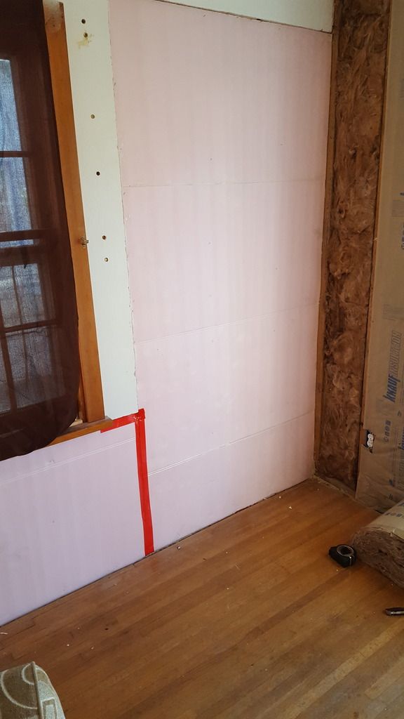

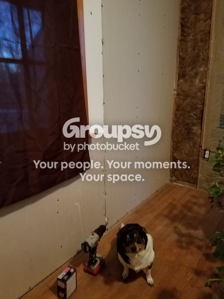

    I'm leary of the overfilled insulation too. I did end up using some R15 in the wall around the door (left over from another project) and although it's meant for 2x4 walls I really had to compress it when compared to the normal R11 or R13.
    I went back to R13 for the other walls....guess it's a comfort zone thing.
    Just like what was mentioned the studs themselves transmit the cold unless covered with board insulation. This of course brings the average R value of the wall down.
    Since I'm only doing the interior of house I decided to take advantage of a very thick (about 7/8") existing drywall to put up some pink board.
    I used left over fanfold insulation (2 layers) over the studs that were filled with R13.
    When I bought the house it came with a dozen or so sheets of 1/2" sheet rock, so I can slap that up over the fanfold to match the existing drywall in areas I did not take it off.

    That was good thinking - to use a combination of foam and dry wall to match the existing 7/8 dry wall.
