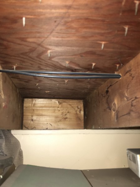

  19. don2222
    don2222
    Nov 10, 2013
    3,438
    4,874
    Salem NH
    Hello
    Here is a good diagram of a rim joist.
    rim joists - Google Search
    Also found this video
    Our house is a split entry and was built in 1962 and the rim joist does not feel very cold Or drafty. There is T111 siding outside and the inner walls are framed with 2x4s in front of the cinder block wall below the Rim joist with R7 FB insulation.
    Our RIM joists are on top of 2x4 framing, not on the cinder block foundation.
    Also Since there is no Ballon Framing, would it be beneficial to insulate this RIM joist along the sides and the rear of this house? See pic below.
    The front has a well insulated overhang so the rim joists are about 2 feet out.

  20. golf66
    golf66
    Jan 22, 2014
    438
    1,869
    That is wrong on so many levels....no king studs, jack studs, header, cripple studs, wall insulation or insulation around the frame. My house was built by Larry Cutcorners and it looks like he did your house as well.
