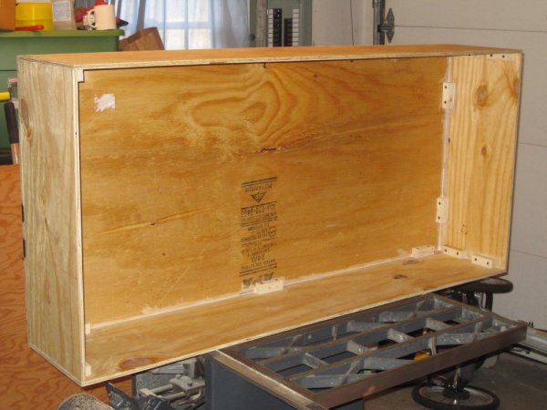

    Here's an image of a box that i built to go over the fold down attic stairs in a rental I was living in a couple of years ago. It's made out of scrap 3/8 plywood that I had lying around. I don't have a picture of the final product, however after putting this in place, I used PL-300 to secure foam board to the outside (2 layers of 2" on the side and 3 on top). The box sat down in the recess of the stairs and had foam weatherstripping around the edges. It significantly cut down on the heat loss to the attic and the oil bill. I think all in I spent about $60. We only lived in the house for a year, but with oil heat, it was worth it. We ended up leaving this improvement for the next renter.

  7. stuckinthemuck
    stuckinthemuck
    3,247
    15,351
    do you have a picture of your staircase block-off? I'm planning to work on one when i get home.. my attic has walkup access with a staircase with a 90 degree turn and landing. I'm planning to use several layers of foam board glued to a couple pieces of thin plywood/subfloor with a pulley system to raise and lower it to stop airflow and radiant heat loss.
