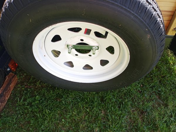

    So the spare tire thingy from harbor fright was $40 ish, from TSC closer to $70.
    I met a fellow at Lowes who gave me this idea: a $9 u-bolt from TSC.
    I set it around a vertical member of the trailer, and on it went.
    Its as low as it would slide down the vertical support.
    I have lock washers to add on later.
    A 3/4" socket and ratchet now live in the truck for removing the tire....
    It's low enough not to interfere with loading too much.
    I suppose a cover of some sort might be a good idea.
    The first load with it there, I will check the height from ground. It could be raised rather easily.

  7. T.Jeff Veal
    29,768
    191,223
    Looks good. Yes, you could rotate the tire and have 1 hole below the clamp would also raise it a bit.
    Horkn, Sirchopsalot and brenndatomu like this.
  8. Sirchopsalot
    Sirchopsalot
    Sep 10, 2020
    3,151
    19,196
    medium city in CT
    No kiddding.
    Wish I'd seen that!
    It looks like there is 6" ish of space. Thats a little skinny esp for pasture type places. Its rubber on metal, so i kinda think I could loosen it if I had to and raise it up.

  9. Sirchopsalot
    Sirchopsalot
    Sep 10, 2020
    3,151
    19,196
    medium city in CT
    Loaded the trailer today with a full load of Red Maple. An inch or better over the rail. The spare had plenty of clearance driving back roads and highway home.

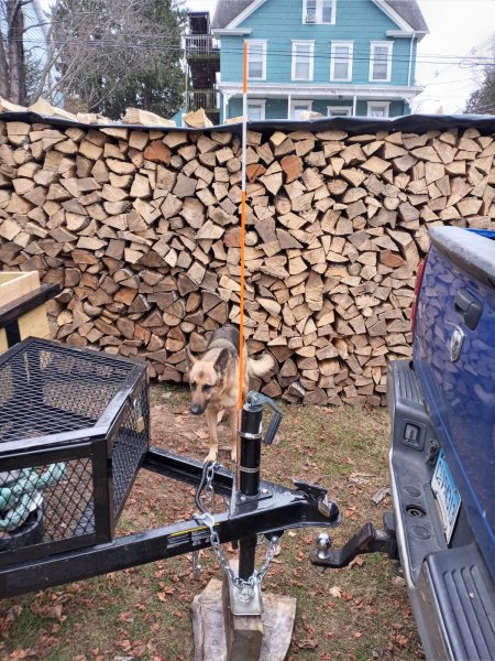

  13. Sirchopsalot
    Sirchopsalot
    Sep 10, 2020
    3,151
    19,196
    medium city in CT
    20221211_111210.jpg I found these nifty fiberglass markers buried at a construction site. 2 followed me home. A piece of copper pipe and some band clamps, and I now have a way to see the hitch over the truck tailgate..

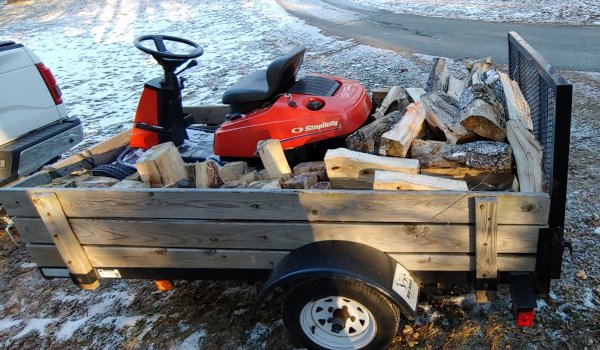

  18. Horkn
    29,236
    166,896
    My buddy wanted this simplicity taken from his dad's to his GF'S place. I figured I might as well make the trip more worth the while by putting a bunch of splits in the trailer as well.
  19. Sirchopsalot
    Sirchopsalot
    Sep 10, 2020
    3,151
    19,196
    medium city in CT
    thats the way to utilize trailer.
    Hate traveling empty.
    T.Jeff Veal and Horkn like this.
