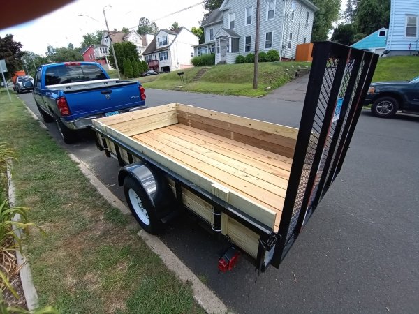

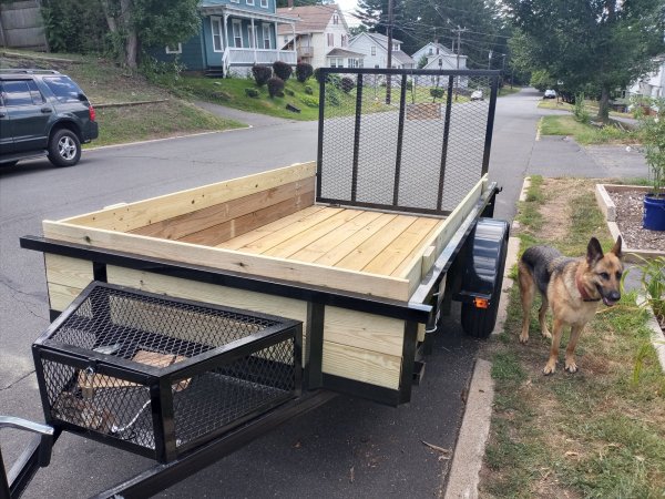

    Before and after.
    Added sides and front. 5/4 pt.
    Worked out ok, except the tailgate doesn't close in now.
    It DOES have 4.stake.bed pockets, but they're under the side rail....so cant put much in them.
    5.5 x 10 trailer. 17.25" sides. 82.5 cu ft. Half a cord is 64 cu ft.
    Will add a handfull of tie-downs to the inside.floor. tomorrow.

  13. T.Jeff Veal
    29,781
    191,333
    Those sides worked out great. Looks good. Nice job

  14. eatonpcat
    10,373
    59,279
    stake pockets under the rail...some fine engineering right there.
    Nice job building the sides!

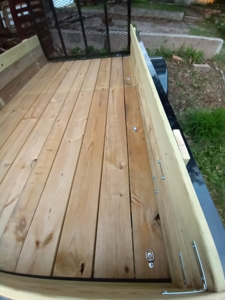

    These tie down gadgets went in yesterday.
    They're rated 600#.
    But the heavier sheet metal screws weren't as tight as I'd have liked.
    I'm thinking I'll fetch some bolts, lock washers and nuts, and drill clean through the bed.
    But They're in, will hold a modest load down, and will certainly allow me to load with wood, and sweep out easily after. There are 8, perhaps more to come. Anchoring outside the walls to the frame isnt something I care to do, except maybe for a load of brush.
    The tires are not radials, but that can happen when they're worn out. I am after a spare, and mounting hardware. We've been blessed with zero flats, but, a spare is a good idea I reckon. I'll take the sander to the upright bits of wood, knock off the edges. No plans for paint or stain, at this point.

  19. T.Jeff Veal
    29,781
    191,333
    Looks good. Yes, I would definitely change out the screws with bolts, washers and nuts.
