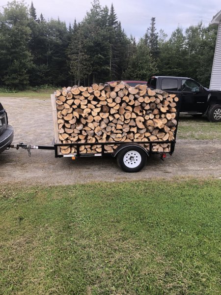

    There is a full 128 cf load of wood on a light 5x8 trailer. Even with another axle different tires and plywood on the floor it is not safe to haul on the road. Frames are way too light especially with the pole only going to the first crossmember. I wouldn’t waste time or money trying to make it something it will never be, I got this cheap to abuse moving wood a couple hundred feet. 113A8429-4FAC-460B-A28B-D906560922B7.jpeg

    That was kinda my thought. It would be a lot of doing to reinforce a wimpyish frame. At some.point, building one or buying one becomes.cost and time effective.
    Minor upgrades might be in line to be able to haul what I already do, with a greater margin of comfort.

    Holy crap. I know you said yard use 200 feet, but I’m amazed it doesn’t just collapse under the weight.

    I have a super heavy duty 5x10 single axle I’m probably going to do some work on. Has 4” c channel frame and crossmembers. 12 ply tires, 7k lb axle, pintle hitch, 2” Oak decking. 8 springs per side, electric brakes, etc. I’ve had 7-8k on it in logs and it pulled fine, while going 500-600 feet on my property. Was an old asphalt roller trailer. I agree, don’t waste time altering that trailer you have. None of its components are meant to be heavy duty. Tires, axle, bearings, springs, frame, decking, crossmembers, etc. I’d sell it and look for a heavier duty trailer that’s 5x10-6.5x12. If you really want capacity get a dump trailer, then you can dump what you haul.

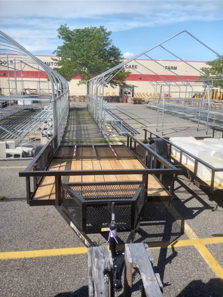

    Welp, bit the bullet, and got a new wagon.
    We hit TSC here in town, price for the 5x10, 2990 gvw, had gone up $500 from 5 weeks ago.
    We did some online searching and ended up in Putnam, Runnings, with a better 5.5'x10' 2990gvw, for $300 less than TSC. And it comes with a little tool cage on the A-frame.
    It didnt come with a foot for the jack, but a harbor fright visit took care of that (got the wheel).
    Built some chocks this morning. I was going to run some 4x4pt through the saw, but then a little voice suggested I check the shorts-shed. They might be too small, but I have something to use till better splits show up.
    Next real chore is to figure out sides. Plywood doesnt come in 10', the vertical supports for the top rail are angle iron (dont really want to drill holes in that) and the top rail is square tubing (dont really want to drill into that/introduce moisture into). 2x6x10 pt decking will make the sides, putting it together it together is the next thoughts.

    ?? for ya...do you want the sides mounted permanently or temporary?
    You could make 2x4 uprights, bolt your decking boards to them, then use heavy duty pipe/hose clamps to hold uprights in place. Stack your rounds of wood against uprights will help hold them in place.
    Doesn't your trailer have stake pockets on the bottom rail?

    I swear I see 2x4 stake pockets on that trailer. If so, that's the easy answer to adding sides.
    That's a nice trailer!
