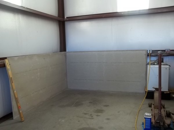

  12. Unicorn1
    Unicorn1
    Oct 31, 2013
    2,282
    8,917
    Amarillo, TX
    My shop has no wood framing but I screwed two 4'x8' sheets of Hardieboard into the corner. This is about 7-1/2" from the wall insulation, I plan to add a second steel framed wall with the bottom open from the floor and a 1-2" space between the Hardieboard.
