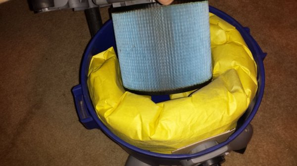

    A shop vac, with a HEPA filter and a Drywall bag (Fine Filtration bag) with keep the unit from spewing ash all over inside the Camp.
    The drywall bag makes sure the HEPA filter stays cleaner longer.
    Im on yr 3 or 4 with my HEPA and it still looks new. I just change the bag when full (make certain you get the Fine filtration bags/ the Shop vac brand is yellow, white is med filtration).

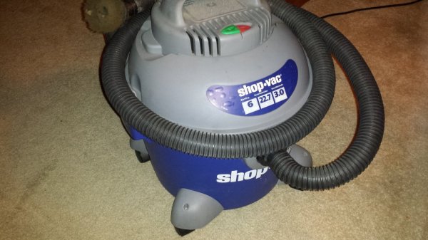

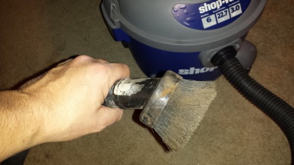

    Here are pics of my smaller unit I use 90% of the time. I have a 6HP / 18 Gal unit equipped with HEPA and bag also. ..
    This one is a 3HP and 6 Gal unit. When empty and clean it is super light and sucks like..... It sucks good :) lets just say that.
    I had a Ash vac. It had a short hose, and I got rid of it after 2 uses...

    I do the same a dex. A hepa filter and a drywall bag. Hepa is there jic the bag decides to rip. The fine dust will go right thru a standard filter. I haven't had the bag rip yet, But its good insurance!
