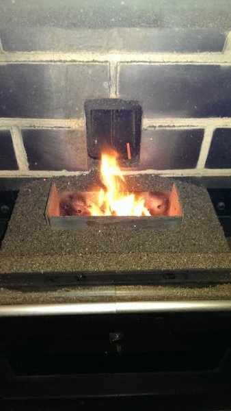

  16. DexterDay
    DexterDay Administrator
    12,411
    31,637
    Northeast Oh
    Gas, can you post up a pic of the pot to show the size. Its prob half (or smaller) than the CPM. Slvrblkk, can you post a pic of the EP?
    How does the EP run on low?? (1-1).

  19. Gasifier
    20,495
    104,020
    I'll have to post a pic tomorrow night. I shut the stove down. It is really mild here. Must be 55 degrees. It is 65 in camp. No need go run it. I am also leaving it unplugged to protect from surge if power goes out with all this wind coming. I don't have a good surge protector yet.
