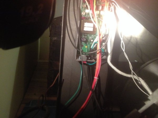

    Prolly wood have been easier if I had done this BEFORE I hooked the stove all up six inches from the wall! :zip:
    Now let's see if I can get the thermostat wire installed without disconnecting the stove. After shutdown unplug it first! :thumbs:

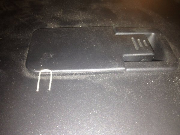

    One jumper removed.

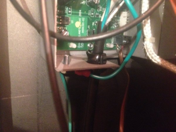

    Back at the spot on the stove where the t-stat is connected was there a jumper that you should have removed? I don't have your stove's manual in front of me. Some stoves can do it with just a switch, some need to have a jumper setting changed, some need a jumper removed and some need a combination done to place the stove on a t-stat.

    The other thing about your stove is that it is possible to have the low firing rate so high that there is little to no difference in the flame from heat range 1 vs a higher heat range.
    There is a diagnostic program for the controller already on the stove that can tell you if the controller is seeing the t-stat and whether it is calling for heat of not.

    Yup. Jumper removed. Pic of it posted in process of doing it.
