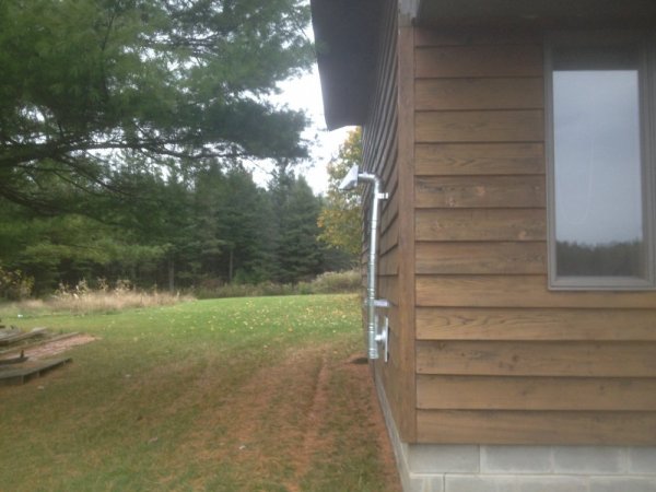

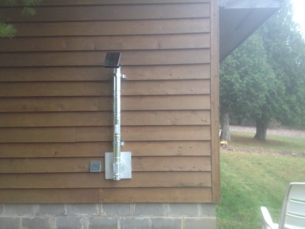

    FOUND IT! Yeah! The volume was all the way up sllvblkk! Yeah! Took a while but I just kept back tracking and going to the places I had been. Daughter kept ringing it and after I thought we were running out of time I could here it ringing!:thumbs:
    Here is a couple shots of the outside. Going to fire it up tonight and I'll give you a picture while it has a nice warm fire in it. I was glad there was a good overhang on the roof. This should keep any snow and ice from hurting the exhaust. I still wonder if I should build something over it to protect it from ice falling off the roof. Cold air intake installed! I also found a s.s. strap from my chimney I installed for stove and now use for boiler. I used that strap to support the upper part of the chimney. They only gave me one bracket with exhaust kit and I used that just above the cleanout.
    Looks like I may have pulled the top back a little to far when I put that support there. Oh well.

  12. SmokeyTheBear
    SmokeyTheBear
    8,320
    39,409
    Standish, ME
    Good news on the phone (I guess).
    You might want to get that taken care of as any non vertical, vertical venting is additional restriction in the system (read this as can put one over the EVL limit for the vent size installed and cause bad burns).
  13. Gasifier
    20,495
    104,020
    You mean that little lean back towards the camp wall? I'll adjust strap so that it is perfectly plumb. I also used all the pipe that was in kit to finish off vertical. There are four sections above T clean out and then the elbow. I figured that would give good draft. Sound right?
  14. SmokeyTheBear
    SmokeyTheBear
    8,320
    39,409
    Standish, ME
    There is a formula for calculating if your vent system will function properly given it's effective length. adding more vent can actually cause trouble and requires that the next diameter size up be used.
    In effect too long a vent run causes burn issues for a given vent diameter. The above a certain diameter you get problems with the combustion blower not being able to push the standing air in the vent out or if the vent is outside the stove keeping the vent gases from condensing before they exit the system. One leads to poor burns and long ignition times (if the stove manages to generate enough of a reduced pressure in the fire box to close the vacuum switch) and the other to piles of ash at the vent where it goes horizontal and creosote in the vent system.
  15. smoke show
    smoke show
    2,983
    13,948
    Pittsfield, Wi
    I believe he used the setup Englander recommends.
  16. SmokeyTheBear
    SmokeyTheBear
    8,320
    39,409
    Standish, ME
    I just told him the none vertical isn't wanted and that there are rules to follow or problems result.
  17. smoke show
    smoke show
    2,983
    13,948
    Pittsfield, Wi
    i just told you what i believe. :D
  18. SmokeyTheBear
    SmokeyTheBear
    8,320
    39,409
    Standish, ME
    I don't think England recommends that slant pipe, nor does the vent maker, just sayin' smoke ole buddy:p.
    smoke show likes this.
  19. smoke show
    smoke show
    2,983
    13,948
    Pittsfield, Wi
    he said he'd plumb it up. relax old geezer. :D

  20. savemoney
    My vertical run is inside. Has a tee off the stove, up three feet, elbow and straight out with a terminal end cap. No vertical outside. Vertical outside pipe cools and can collect more soot. The three feet up was all I needed to prevent back puffing that might occure in a power outage, or some blustering winds. My son installed his stove out and up, but says he hasn't had any issues. But then he seems to be as anal as I am about cleaning the unit. Clean=best heat.
