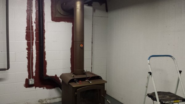

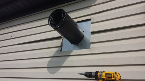

    Well it is not ready to burn yet.
    I still need to:
    Vent the outside air intake.
    Caulk everything outside around the cover plate for the thimble.
    Attach mounting bracket that holds chimney.
    Put the chimney together going up and put cap on.
    Oh. Forgot to ask you guys a couple other questions. The "receiver" for the first piece that goes on the back of the stove outlet (which is the adaptor) has a pretty thick wall on it. I know the manual says to not use screws longer than 1/4" because you do not want to breach inside of pipe at all. Is that "receiver" wall fairly soft? It looks pretty stout. Wondering if the self tappers go into it that easy. So I need 3 self tappers there. Do you guys use self tappers anywhere else to hold chimney together? It is all twist lock. Seems to be pretty tight when done. I am thinking of wind outside as well. They give one bracket in kit and say to put that on right above clean out T. Makes sense. It comes out to fit nice and I will attach tonight. But I am going to go up with all the pipe they gave me. I should probably put another bracket higher up I would think. So the wind does not push the pipe with that big cap on it.

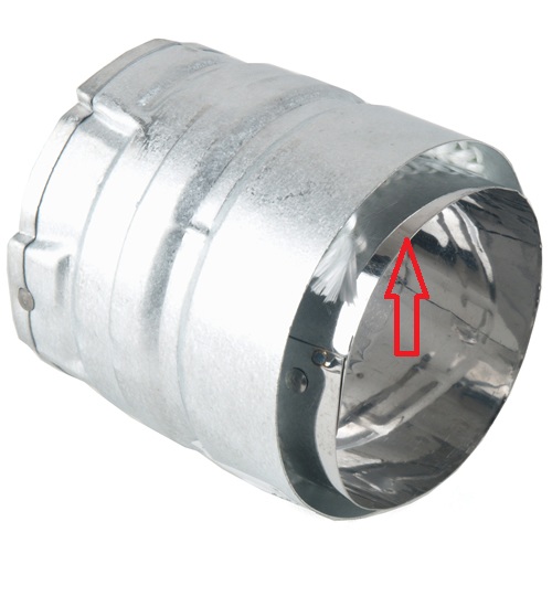

    Just to be clear, this is where you need to silicone and then screw:

    Don't forget to seal around the vent pipe on the outside where it exits the thimble. You have a ring around that vent pipe that is open to both the inside and outside of your camp through which smoke can pass back into the camp.

    I have silicone tape around the joints that I take apart to clean and foil tape around the ones that I don't take apart and are basically permanent (just on the inside of the house). And yes, where the self tappers go, that wall is on the thicker side. I don't have anything else screwed together.

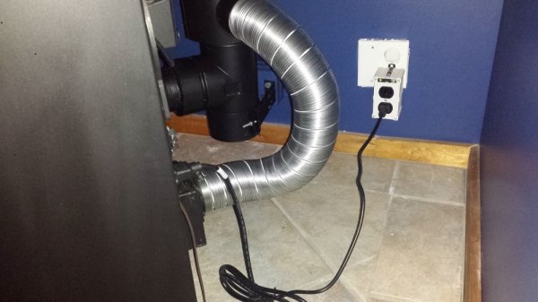

    By the time that 10° air comes through the intake pipe (wams up), enters the back of the unit( wamer), and comes into the burn pot receptacle where its about to meet its death (pretty warm). That flame is aaveraging 1,500° so the difference between 68° inside air and 10° outside air? Really isn't much at all.
    The colder air is more dense and rich with oxygen. Aldo, as noted above, you can throw heated air out your exhaust, and drag cold air in from the farthest reaches of your camp (making it harder to heat, because your entire home is under negative pressure). Or you can run an OAK and keep the system a closed loop. Thereby keeping your home nuetral pressure and being able to take that heat a soread it back to the farthest reaches of the camp.
    Alright.... OAK. First time it's been discussed here and won't be the last.
    I have an OAK on everything I own. The last install I did on my new Enerzone, I used Selkirk DT venting. The O.D. is 6.5" (looks like wood stove pipe) and it draws the OAK air around the inner 4" exhaust. So you only have one hole and the intake air is preheated (not that this really matters, but on damp days, ash has been known to "Cake" a little more because of moisture).
    Just started painting the basement, so its hard to see the black OAK pipe against the Dark red paint.
    Thats what I should be doing now. Painting...I wanted a break! :)
