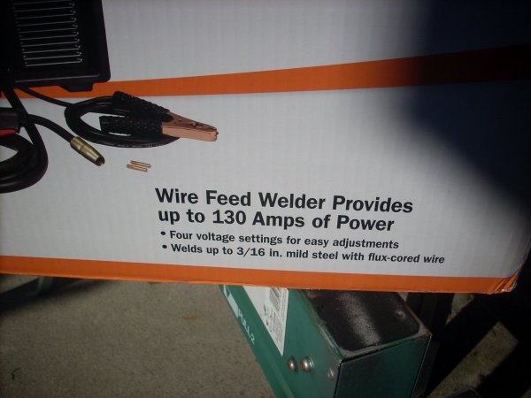

    I literally just walked out of TSC with this welder! Clearence of $279.99. You can't beat this little welder for small things around the house. The reason I bought it is it (Plugs into 120V), :cool: The house. This will save me lots of time from dragging out my gas welder or the big boy on the trailer. :whistle:
    Last year I looked at this welder and it was $379.99. They're clearing out the 125amp machines and going to 140amp. For what I need, this is perfect sometimes! :yes:
    Pics below.
