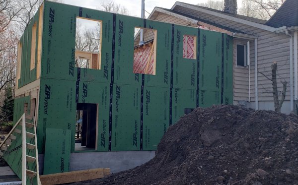

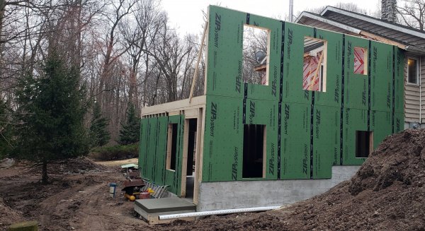

    I do not like to critique others work, especially in other areas. Carpentry varies from region to region. And again I am looking at a small pic and making Assumptions based on that so I will proceed cautiously I might be 100% wrong.
    1) I first "see" any wood touching concrete has to be pressure treated, plates and the wall studs , concrete is a giant sponge, white wood will be wet and rotten in a few years.
    maybe it is again I am looking at a small pic.
    2) what is going on with the window headers? I see two questions.
    A) why is it a single 2x12 and not double with OSB or plywood in-between
    B) did they frame it wrong and add 2x on the bottom of header too shrink the opening?
    Bottom of 2x12 header should be top of window opening and 2x cripples above
    3) same with above doors double 2x12 defiantly on the structural walls
    Just my 2 cents

    Mike I have a policy of not criticizing other peoples work without knowing what they’re doing and thinking. My questions would be what is the wood framing below the header on the windows?
    How are they tying this into the wall the other house where the looks like a dryer vent maybe is?
    Here they would’ve put some insulation in the cinderblocks, that might not be a standard building policy there.
    I am not a professional ironpony is
    we were typing same time I agree on separating concrete and KD
    savemoney, T.Jeff Veal, Chaz and 2 others like this.

    By saying concrete do you include cinder block? On the screen I'm looking at, no wood is touching the poured concrete.

    IMO the siding needs to come off and the wall opened up to add blocking/framing/structure to tie them together but we have not reached that point yet.

    All the lumber toching concrete is pressure treated. It's just the pictures .

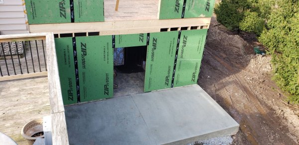

    Planning on them having a door to the deck. Don't see the pup watching from up there today.

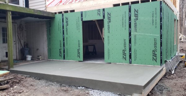

    Had to section off the deck to keep the dog away. Actually, part of the deck will be demoed and replaced eventually covering the whole walkout concrete pad. Yes there will be a sliding glass door out to the concrete patio and onto the deck.

    More framing progress. The chimney for the wood stove will be gone tomorrow. It will be moving a few feet over in the end. Patio concrete was poured too. 20200312_192839.jpg 20200312_192902.jpg

    3,924
    22,456
    BTW, the "drier vent" is actually the outdoor air for the stove. It will obviously be moving, since that will will now be an inside wall.

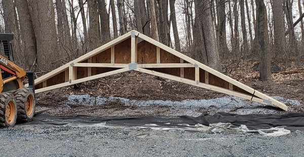

    Always hard to tell from a picture. The window and door headers do look different, but with fairly narrow openings, they wouldn’t require a 2x12 header here, a s it looks like a double to me and rather than frame them at top of window height, it was simpler to place the headers at top plate height, and simply fir them down with solid framing for simpler trim attachment later on.

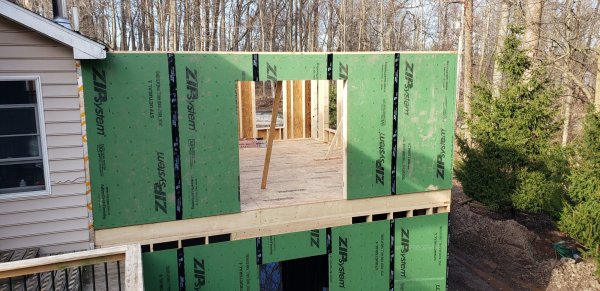

  20. mike bayerl
    mike bayerl
    Nov 15, 2014
    3,924
    22,456
    More progress today. Upper floor walls in. Roofing starts on Monday. We will lose the chimney then, so this weekend is our last days of burning wood for this season. 20200313_165609.jpg 20200313_165020.jpg 20200313_165025.jpg
