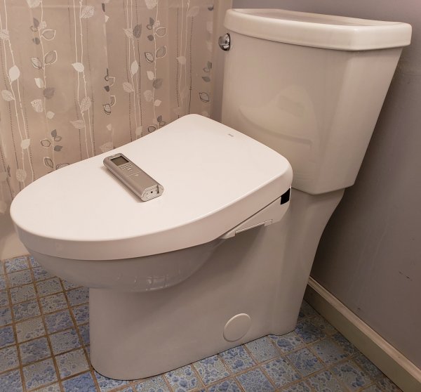

    We replaced the old, cheap, low toilet in the spare bathroom of the main house today with a nice, modern, ADA-compliant one today. Father-in-law really appreciates the taller seat. We also put in a Toto Washlet for warm water and air cleaning for the nether regions. Yes, it does have remote controller. :loco: :crazy: If he likes that, we'll put those in his new addition, too. He's been asking about something like this for a while 20200301_210734.jpg to help with hygiene.

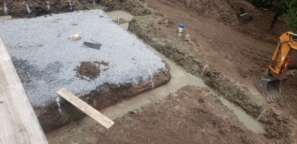

    Footer poured and block delivered today.

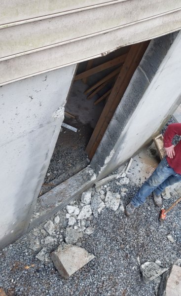

    And now there is a large hole in the concrete wall. Hours of work with a Stihl MS461 concrete saw. Crappy drizzy day today.
  6. TurboDiesel
    16,241
    97,578
    Do it while the excavator is there.
    Even if you gotta rent it!
    You might need to switch the controls if you're used to one kind. I can't run excavator (Cat) controls...

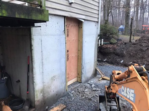

  11. mike bayerl
    mike bayerl
    Nov 15, 2014
    3,924
    22,456
    Door boarded up as the rain came in this afternoon. My wife says our foot/foundation is currently a moat. Will have to keep an eye on that.
    89251500_3097189776958763_8913980120612470784_n.jpg 89345388_3097190563625351_7232940967613956096_n.jpg
  12. ironpony
    ironpony
    3,749
    20,844
    Mid Ohio
    footers look kinda shallow for Pa. are you adding a lot of fill?
  13. mike bayerl
    mike bayerl
    Nov 15, 2014
    3,924
    22,456
    All done to local code and inspected before poured. I'm no expert so I have to rely on that, I suppose.

  14. Canadian border VT
    19,709
    131,231
    Ask about a footing drain. Saves tons of future problems
  15. brenndatomu
    25,220
    164,052
    I was thinking the same thing...

  16. Stinny
    14,138
    60,665
    No such thing as too many drains... :yes:
  17. mike bayerl
    mike bayerl
    Nov 15, 2014
    3,924
    22,456
    Yes! I will. I HATE water in houses.
    savemoney, T.Jeff Veal, Chaz and 7 others like this.
  18. Canadian border VT
    19,709
    131,231
    Except for sinks toilets showers... come on man it’s the 21st century :D
  19. The Wood Wolverine
    18,901
    121,882
    Lol, no getting anything past y'all! :rofl: :lol:

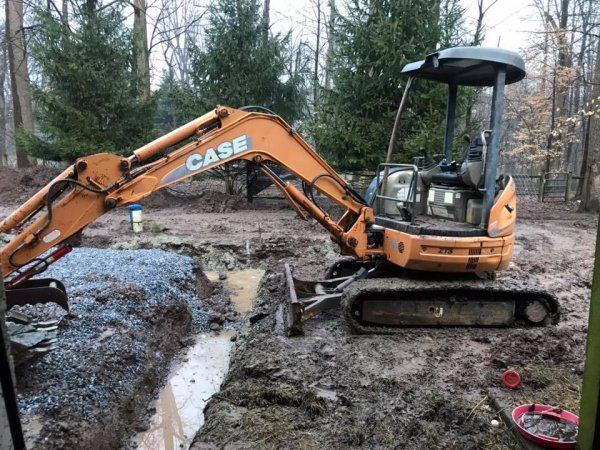

  20. mike bayerl
    mike bayerl
    Nov 15, 2014
    3,924
    22,456
    Laying block today. BTW, there will be a foundation drain even though it is not technically required by code. Yesterday when it rained, the existing foundation drain for the main house was actually running in to the footer trench because they needed to open it up when excavating against the preexisting cement wall 20200304_092819.jpg . Also, some of our downspouts were also temporarily heading into the trench. Thanks for keeping an eye out for me. Much appreciated.
