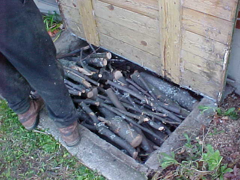

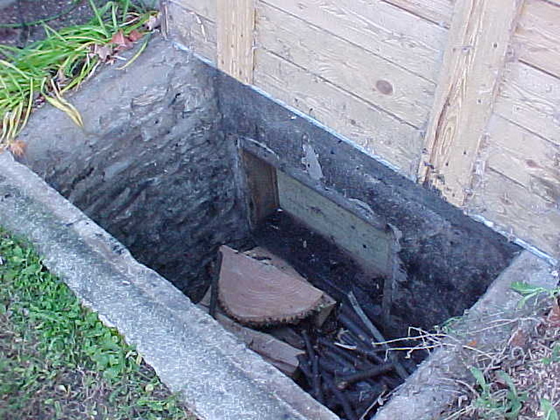

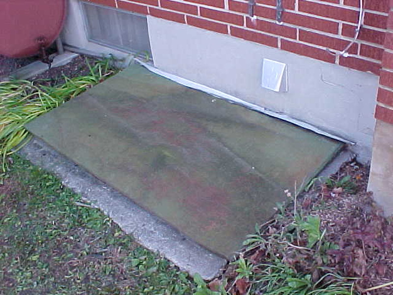

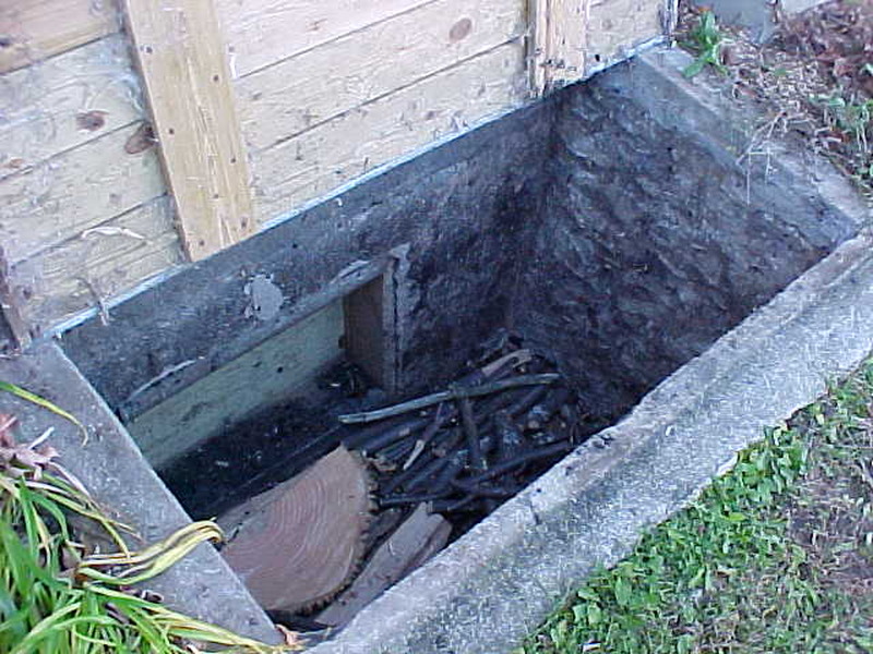

    If you have it in the basement. might want to consider this. This is my Dad's set up.
    We made a wood chute that we fill from the outside. Homemade door by chiseling out concrete blocks in the foundation wall.
    Pressure treated lumber frame support doubles for support and easy hinge hanging. Put at at an easy height to reach into. This way the bugs don't awake till there in the stove and the dirt stays in the chute that you can clean if needed from outside.
    We hand dug outside down below the level of the door with straight sides. Dug several place clear down to the curtain drain surrounding the house foundation so any water can get away. Poured a sloped floor TOWARDS the house so logs roll or move forward easier. Then laid the sidewall with the sheet limestone rocks that were dug out.
    The top, perimeter edge is sloped out so water moves away from the house. The edge is flat at firt, then tapers put where the lid isn't.
    Pressure treated boards used for the lid.
    Then covered that with some sheet steel. Edges a little bent up on the flashing but it's been in use for over 40 years now. It hold about 3/4 of cord of wood so He brings a decent size truck load to fill. When we were kids, we did it with a lawn cart and sled when we had snow.

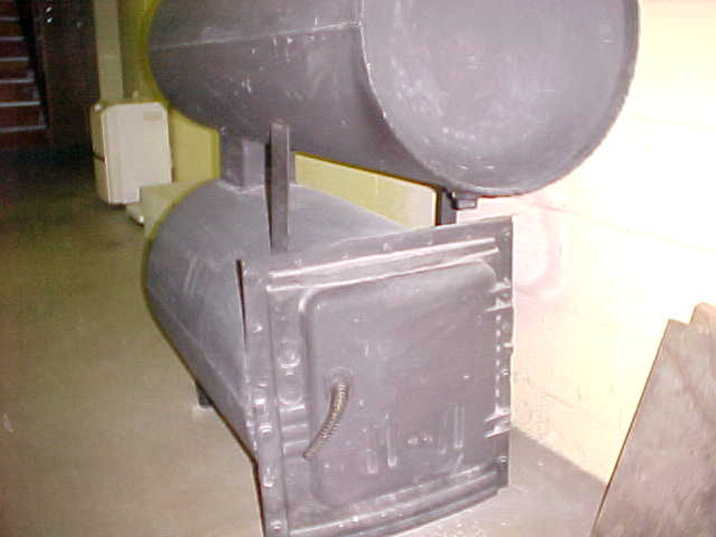

    Here is a shot of the business end of dad's stove he made. Used boiler tanks and put an old coal furnace door on the end. Only change was he had me put a larger outlet on for the flue from the 5 inch he had to start. Over 40 years of use and the sole heat source for the house. Oil furnace has not been used during that time.

    I think I saw the same design on Pinterest .
    Yours looks great BTW!

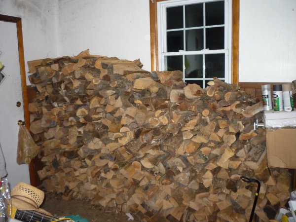

    A friend of mine keep 4 cords of wood in his basement at all times! I asked him aren't you worried about bug termites etc. He said no that they bug bomb that basement every two weeks! He said that they have no bug problems what so ever .
    Talk about staying stocked up!:thumbs::hair::dex::stacke::stacke::stacke::stacke::woodsign:

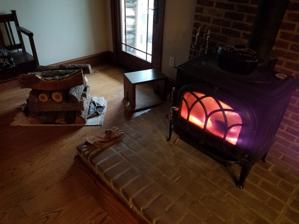

    Here's a pic taken just this morning of the amount of wood I'll store indoors.....maybe a little more on top of this little stack, but only enough for a day or two. I don't like bringing a whole bunch of wood in to the house.

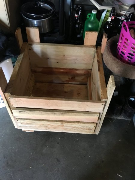

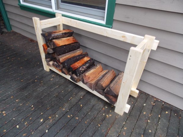

    Likely to use this just in the garage to store stuff that might not be safe in the house until it goes into the stove. IMG_1258.JPG I have oak boards with nails in them and wood blocks from pallets. These things have something similar to a nail but like a reverse one. Im also likely to build a more attractive wood stand for the patio. Something a little bit like this. IMG_1530.JPG
