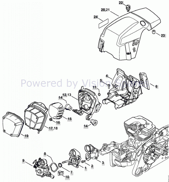

    I have a ms362 and I was wondering if it has an impulse line.

    Looks it its incorporated into the intake boot.

    036, 360, 361, 362…it’s in the boot. Comes from the crankcase via hose and connects to the backside of the boot on the older ones. 362 has a hole cast into the cylinder that matches to the bolt-on boot manifold thingy
