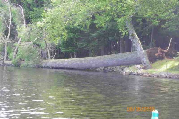

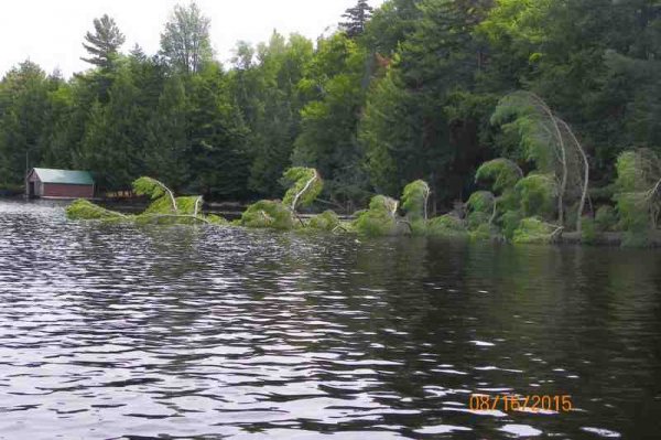

    Here you go Steve , you can get some practice on this! :yes:
    The water in that area is about 4-5 feet, maybe less, so the limbing up of the tree should be easy but getting the big azz logs out would be tough.

    Id be tossing a swimbait under that one woody! :seasoned:

    I don't even have my license, it was up at the end of July. I don't even have a ole in the boat.

    :faint:
    hollow it out and paddle it to shore
