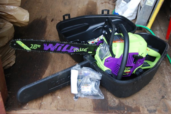

    OK, how about this mint gem new Wild Thing! This PLUS the $200. Comes with a case and oil... its never been fired up. A virgin saw!
