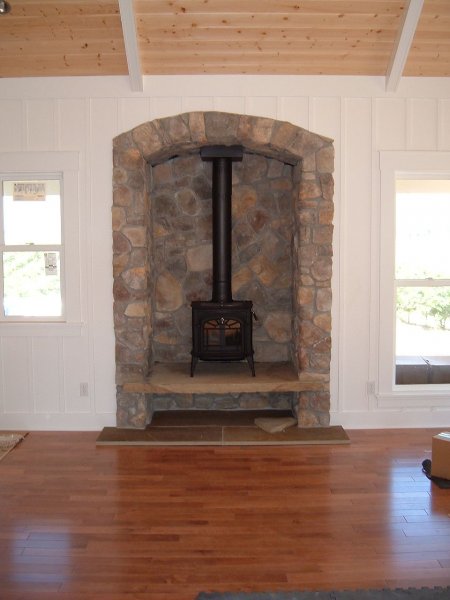

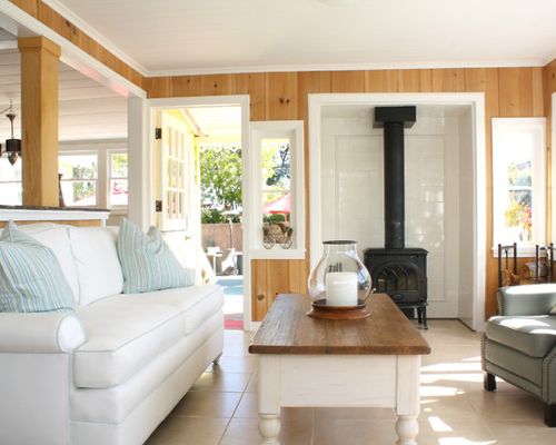

    I would not do a fireplace for heat. It's 2018, not 1918.
    Hearth, freestanding wood stove.
    I would do an alcove for a wood stove like they do for vented gas fireplaces, just big enough so there are no clearance issues if I was building new.
    You get sort of the look of a traditional old-fashioned fireplace with the efficiency of a wood stove.
    Plus you don't lose floor space to a hearth. Especially if the bumpout is deep enough / part of the poured foundation rather than cantilevered with litle depth.
    f8e603f12597a1622d48cde796b63e23.jpg 876150b9024505a7_7582-w500-h400-b0-p0--traditional-living-room.jpg
    If the bumpout is deep enough you can have no hearth intruding in the room.

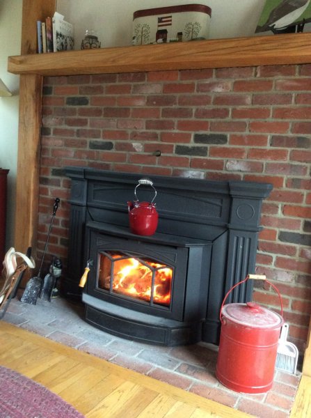

    We’ve got the HI300, Hampton is in the Regency line.
    We built 20 years ago and plugged our fireplace with this insert 10 years ago. If I had a do over I would have placed a fireplace foundation right in the center of the house, instead of at the very end of a room that is at the very end of the house. Second I wouldn’t have put in a fireplace: it would be a stove or insert or similar.
    papadave, Maina, blacktail and 4 others like this.
