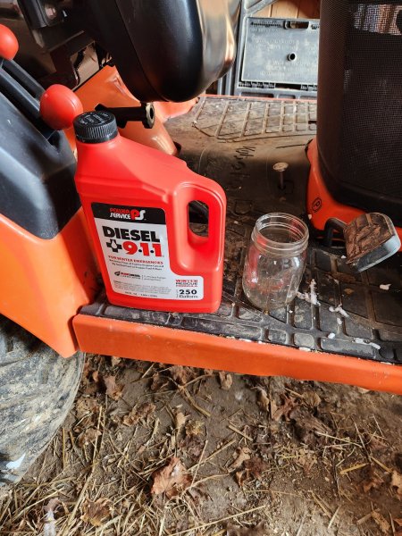

    Wish me luck ! New filters and Howes still not here yet. Even have a Mason jar with Oz measurements on it lol.

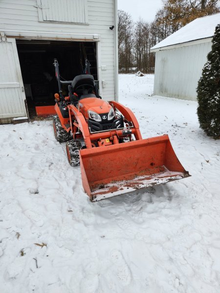

    Ran for 2 hours. The engine still wants to hunt a little. But had good power ...hopefully got enough of the 911 into the cheap inline filters to help until the new filters arrive. Even ran the pto to get the rear axle..and maybe fuel tank and lower filter area a little heat (long shot) .Got the 2 inches of packed down crud scrapped off the driveway...ice melt down. No slips and falls here !

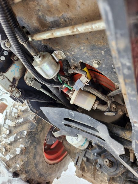

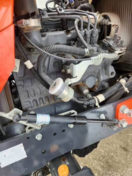

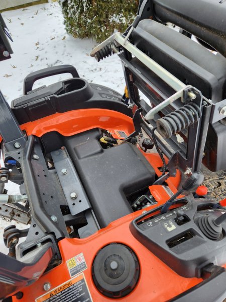

    Did some thinking last night. To get the fuel working with the heat gun the other day... I had to concentrate the heat on the fuel pump and first inline filters. To those who aren't familiar with a BX....the fuel tank is under the seat. Then right in front of the rear axle is the first inline filter..into the fuel pump. Then it goes all the way up to the second filter by the engine..into the injection pump. That's a long way to go ! My thinking is that the water is mostly getting me in this first filters and steel fuel pump.
    My Dad's bigger Kubota tractors have all had the fuel tank under the engine hood..in front of the steering wheel..right down to a big filter/separator. As long as the machine starts....everything gets warm enough under the hood to keep the fuel warm . Never have used conditioners in those tractors...and they get used all year round. This little bx has alot going against it in this cold. I'll be better prepared from now on...and it won't be a big deal again..hopefully !
    Think the new filters will definitely help. Gonna start changing them right before winter from now on.
