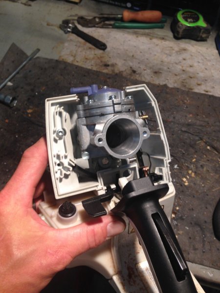

    The carb I showed is a non mtronic 661 carb
    Shows zama on it
    blacksmith likes this.

    Those are the ones definite dave sells

    Yea zama china. I guess its the wj69 copy

    It's not a wj69 copy of you look at the plastic linkage for the choke you will see the difference
