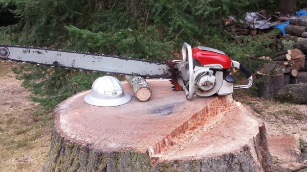

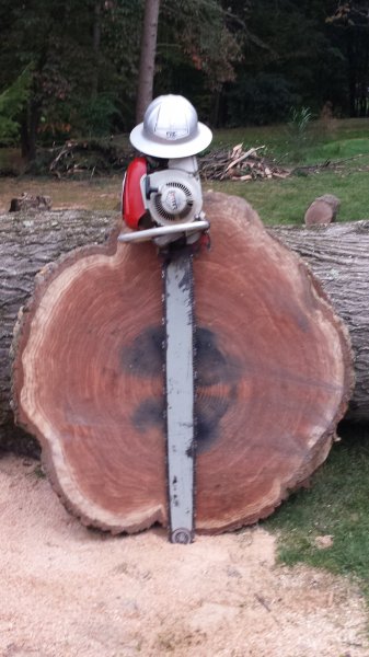

  15. blacksmith
    blacksmith
    Jun 2, 2016
    1,425
    7,490
    central Pa
    Here I am again with my 661 not starting. Had it to the dealer because it wouldn't start. They had to put another fuel mixing solenoid (2nd one in 8 months) on it as I mentioned earlier in this thread. Just the other night me and Scotty Overkill went to drop the trunk on a big old oak and my saw wouldn't start at all! Sometimes it does this and the next day it with start. Not sure if it's because it was sitting in a hot truck all week? But went to try to start it today and it didn't even sputter!:mad: I am wondering if it's the fuel mixing solenoid again. Even though it's still covered under warranty the price on the sheet is the same price as a WJ-69 carb, I wonder if they can finagle some paperwork to give me a carb so I can end this nightmare! :sherlock:Anyways here are some pictures of the tree that we dropped we use Scotty Overkill's 1959 Stihl Contra with a 42" bar.
