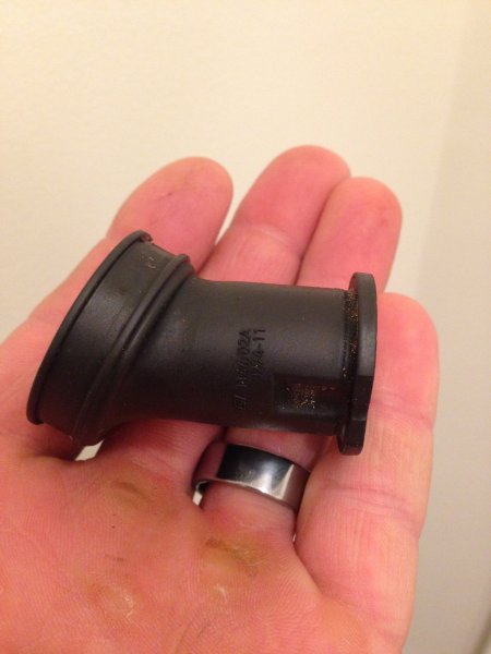

  7. Redfin
    Redfin
    Mar 1, 2015
    922
    4,269
    central Pa

  8. Redfin
    Redfin
    Mar 1, 2015
    922
    4,269
    central Pa
    Im at 2100' which would lend to a richer tune than yours.
    Even though the hd2 can appear to be clean and dry they still can be clogged with fuel soaked fines. Try it without the filter.

  11. Redfin
    Redfin
    Mar 1, 2015
    922
    4,269
    central Pa
    It is between the carb and cylinder.
  12. Redfin
    Redfin
    Mar 1, 2015
    922
    4,269
    central Pa
    Next time you run it. Let the saw idle for a bit before you shut it off.
