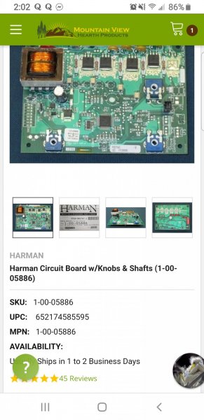

    To help slvr out here, it will have a standard through hole mount, with a clip on heat sink, BUT Harman boards are layered, so the solder has to make connection with the inner layer. I think that is what he was looking for.

    Ok. Few days. Got a new board ordered 209.00. Got 20.00 off for posting a good review of my ignitor purchase lol . Works 4 me. Mountainview stove parts

    Not a bad price. Back in the fall, up at my sisters, I needed one "right now", so drove to Mountain View, and it was 235, or a bit more.

    not the Platinum

    Ah,yes, I was wrong, again, sorry. Looked at my receipt, I paid $229. for the new "Platinum" board. And, that was walking in the front door and paying cash.

    not a bad price......all revision F are "platinum"

    interesting.. mine shows 2.47 amp on ignite.
    0.12 when light goes off.. just installed new board ..
    must have had a bad triac.... was getting well over 2 amps when ignitor was supposed to be off.
