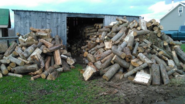

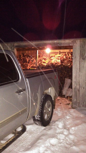

    This is when I had my owb, since I sold it I use the center of the shed, halfway in

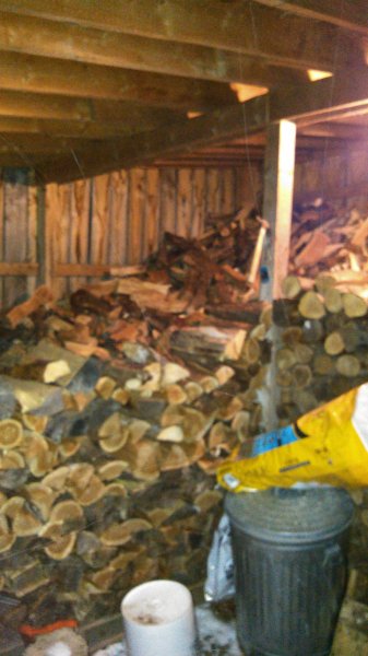

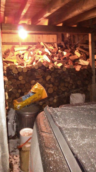

    My wood shed is 16'x24' not 16x32. So basically I have 3 bays one is 8'x8' and the other two are 8'x16'. The smaller bay is where my owb used to be, so instead of leaving a center isle to feed the beast, now I can use this area for wood and have an 8x8 area to back my truck in to get a load of wood or drive a load of wood in on my tractor. I have always had lights in my woodshed as this is definitely a necessity for me. The opening of my shed is 8' wide x 6.5'-7' high. I think at least 10' wide and 8' high would be much better for backing my truck in or coming in with the tractor. The new boards along the back wall is where I filled in after removing the owb.ATTACH=full]148375[/ATTACH] KIMG0116.jpg KIMG0118.jpg

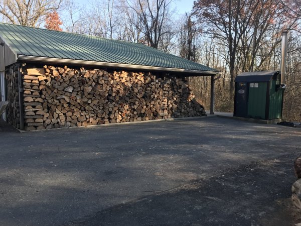

    325E63F2-0B5D-4C65-A6E7-06855EC373C3.jpeg Mine is 8 x 32 and built onto the side of my barn, with the own at the far end.

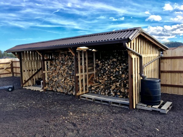

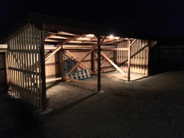

    16x25 with metal roof and studs on 2" center (2"x8") so no post. There have been
    2 years we had a heavy snow load and I placed temporary post on every other rafter,,used landscape timbers for post.
    Used bunker tarps so it's "convertible",,open/closed.
    Electric supply, concrete floor.
    6' 1/2" inside clearance on the back, 7' 8" on the front.
    8' sliding door centered on the business end,,a 2nd door would be handy at times.
    If/when I ever decide to finish it,,I will use "perforated" barn metal so it can stihl breath..
    it could be bigger!

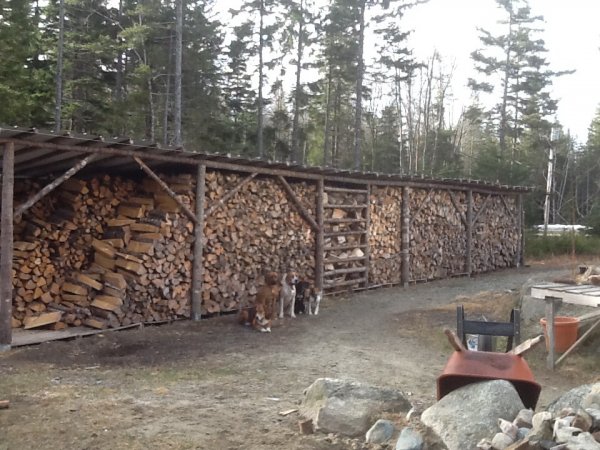

    8 X 50 woodport made from spruce poles with pallets for the floor and a steel roof

    NICE!!!! :cool:
